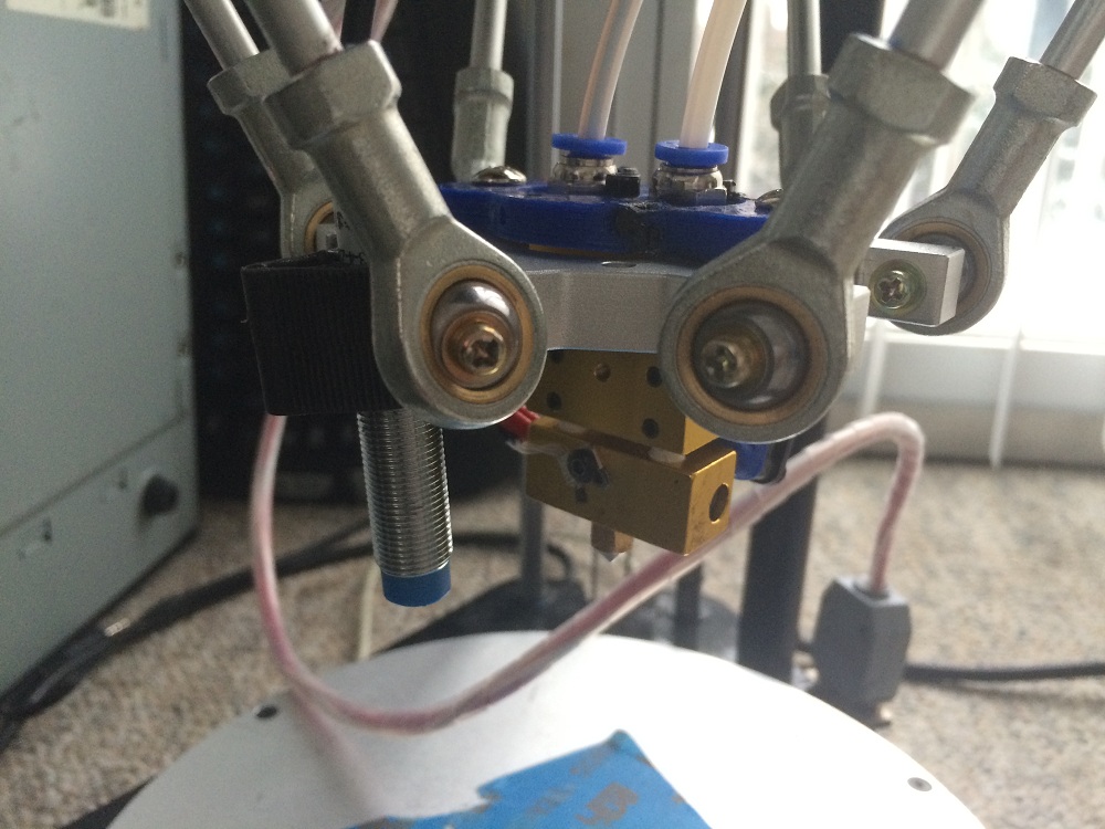

Thank you Mark for reply, you got it right! "G2S extruder2 drives axial motors when printing". The solution linkhttp://www.geeetech.com/forum/viewtopic ... 13&t=17064 you suggested, did work for double hotend (two thermo sensors and two heating elements). It's complicated with Delta 3D printer and mixing hotend (one thermo sensor and one heating element with 2 or 3 extruders).
G2S 2in 1 hotend mount

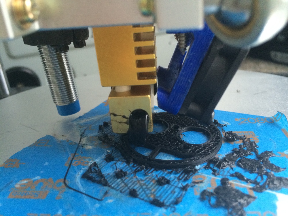

E0 Printing single color

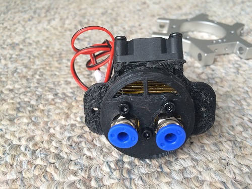

G2S fan and 2in 1 hotend
2in1 hotend.JPG (264.2 KiB) Viewed 8370 times

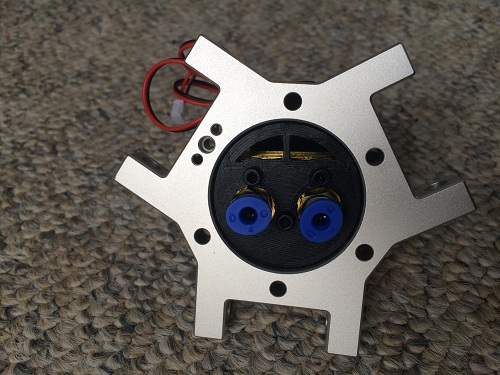

2in 1 mount 4 G2S 3D printer

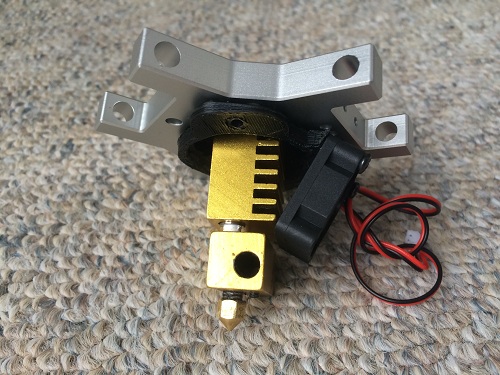

2in 1 hotend mount
2in 1 hotend mount
