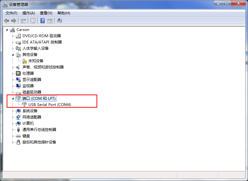

Hi,Edvash
Has your devices manager detected this?If it has,you must choose the corresponding "COM" port in your slicer software.
If hasn't,you can try to change a USB port or a USB wire,that may work.
If all above have done and it doesn't work,i'm afraid you'd better return to the firmware you used before.
