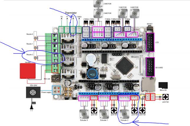

printing 3D with M201 Geeetech
Re: M201 - GTM32 Suggestions & Questions
where dod you connect the secend hetear please?
the circle i drwr in the picture that are the ports i want geeetech will enabled on the firmwere
thanks
yossi
thanks
yossi
1st Heater to Nozzle0
2nd Heater to Nozzle1
1st Thermister to T0
2st Thermister to T1
GTM31_DUAL.ZIP does support 2 Heaters and 2 Thermisters.
Specify in Slic3r what heads to use. Only problem after printing Head 2 does not switch off automatically. Need to add G-Code for that but did not get to it. So just reset printer after print job complete.
Nozzle 2 & T2 and Extruder 2 is what you need 3 head and where Geeetech do not help.
ohhh ohhh correct .... with the firmware of the dual....
i want to do it with the regular firmware , sincr i want to use also the 2in1 and also the second mk8 thai i install there
so i dont understand why geeetech want do the fiemware with this ports alsoo to the regular fw if they do it on the dual FW it can be done very east to the regular FW
this want eggect any way the use of the printer. just add the T2, NOZZLE2 AND EXTRUDE 2 to the board
geeetch!!!! please add them !!!
