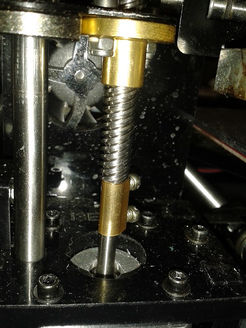

Pictures as requested
Lead screw and 5mm to 5mm coupling, I turned the lead screw ends down to 5mm
Lead screw Coupling.jpg (156.27 KiB) Viewed 15166 times

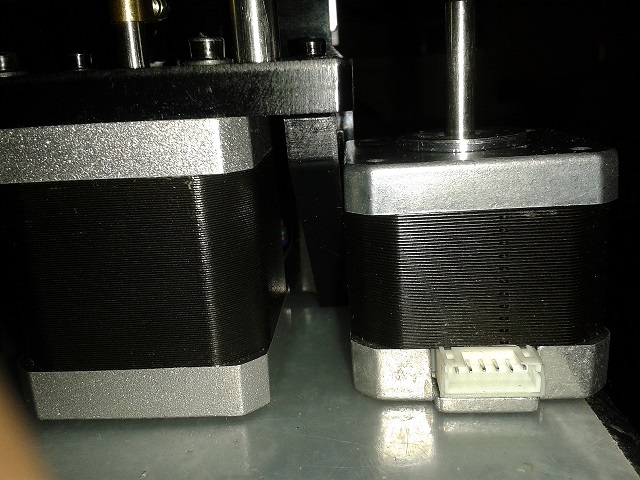

Nema Stepper 0.9deg
Nema Stepper 0.9deg
Stepper Nema09_48.jpg (126.8 KiB) Viewed 15166 times
Nema Stepper 0.9deg

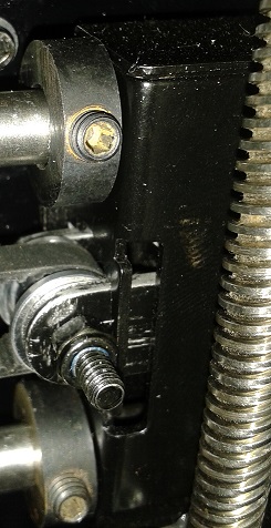

Locknut on Z stop min
Locknut on Z-min Stop.jpg (66.52 KiB) Viewed 15166 times

Grinded Bar Locks
Grinded Bar Locks
resized bar locks.jpg (76.38 KiB) Viewed 15166 times
Grinded Bar Locks

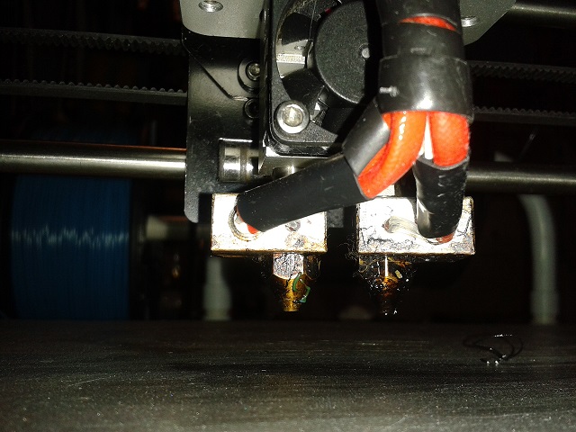

Dual Print Head
Dual Print Head
Dual Printhead.jpg (113.73 KiB) Viewed 15166 times
Dual Print Head

Move right down to end stops, select z-max end stop. try the settings. Remember end stop will only work if axis max is greater than end stop position.

No, I bought Two hot ends (the smallest I could get), Two nozzles, Two thermisters and Two 24Volt heaters in order to swap back when I want.
Just remove the last aluminum block 2 into 1. And assemble this. Easy to revert back to 2 in 1 out.
The biggest secret is setting the two heads very accurate same distance from print bed(Main reason why I replaced flexible couplings and lead screws).
Then in Slic3er you specify the offset of the two heads, there is a nice STL file with 4 checker squares you can use to fine tune and play with retract of fillament etc.. Can't remember the name now.
