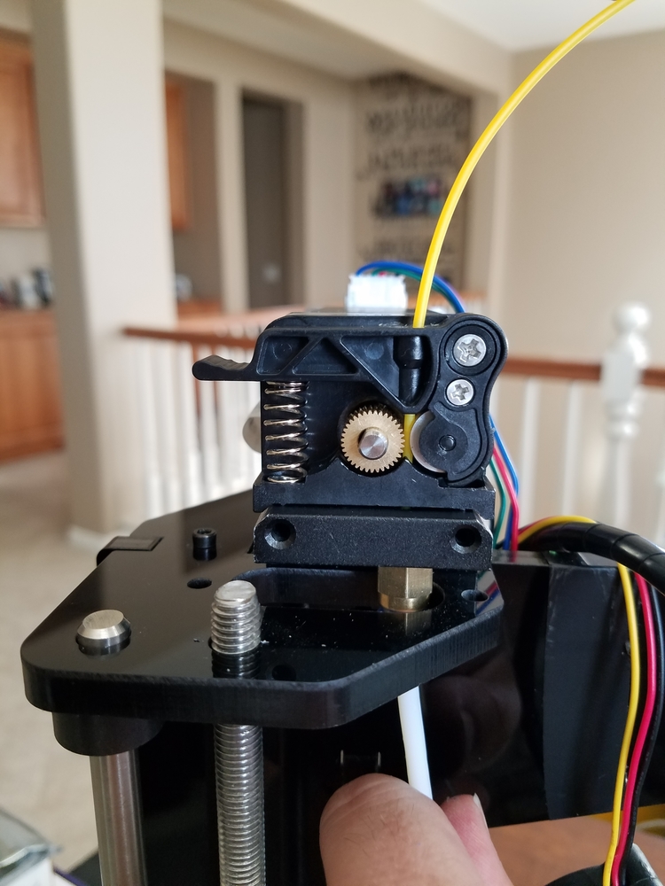

We had the same problem- turns out we had the brass nipples on the top when they should be on the bottom. There are teeth inside that hold the tubes in place.
20160810_180336 (1).jpg (396.57 KiB) Viewed 7234 times
