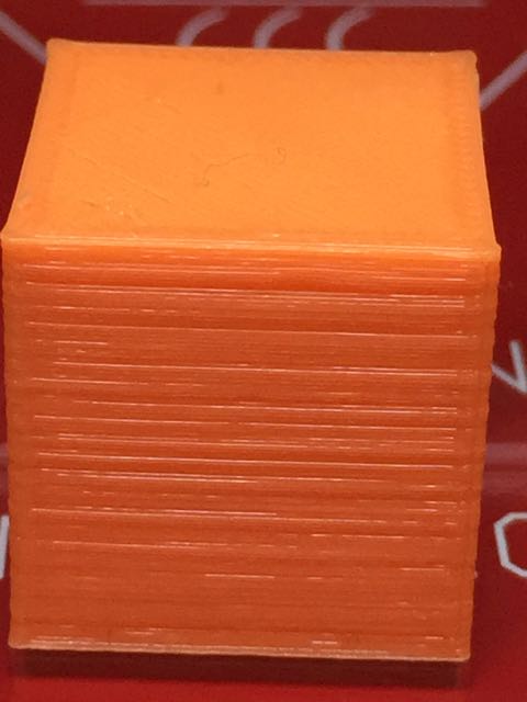

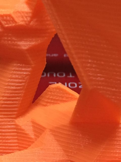

I'm getting quite decent print quality + some terrible z banding.
With Z Supports
With Z Supports

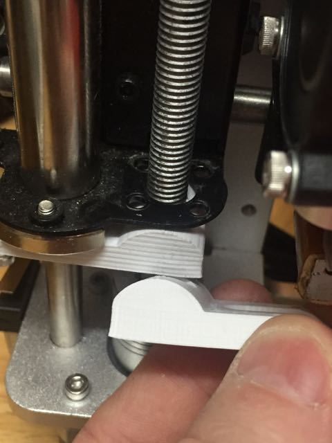

I pulled the z supports off and ran the head up and down.
Without Z Supports
Without Z Supports
One of my threaded rods seems to move in large circles at the top where the other moves in a small circle.
The brass bush on the "wobbly" side is quite tight where the side that doesn't move around a lot can actually be wobbled in the bush itself.
I did a print of a calibration cube with no Z supports and it came out much better than with the Z supports on.

check your rods are bended or not, and the couplings on the Z axis, are the two holes of it line up with each other? how's the coaxiality?

Print these 2 brackets and remove the brass nut.
http://www.thingiverse.com/thing:1431036
They do a fantastic job.. The wobble is not transferred to the print.

Before and After
So much better. Thank you :)
