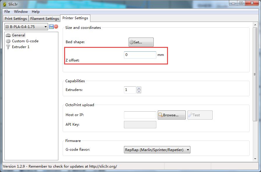

Did you level your bed as the manual shows?
If you did,try to set the value in the picture to -5 have a try:

Thank you. Tried it, but had the same problem. got hold of settings in the firmware and after a lot of hours i got the problem solved. Thanks for the reply :D
