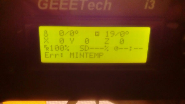

I received the Prusa X and I have finished the assembly. The machine seems to work fine except for the extruder thermistor. This thermistor is not working. I have checked it is not a problem of the electronic board, since it works fine if I connect instead the hot bed thermistor.
I can see the broken wire.

Could you take a picture of it and the status of LCD?I can see the broken wire.

Re: Extruder thermistor not working
This is an image of the LCD screen. Please, note temperature is zero
And in the following video you can see the thermistor fails, there is a wrong crimping of the wire:
The thermistor cable is too loose,which make the thermistor has no a good connection to the heating block,and you can tighten it with tape.
