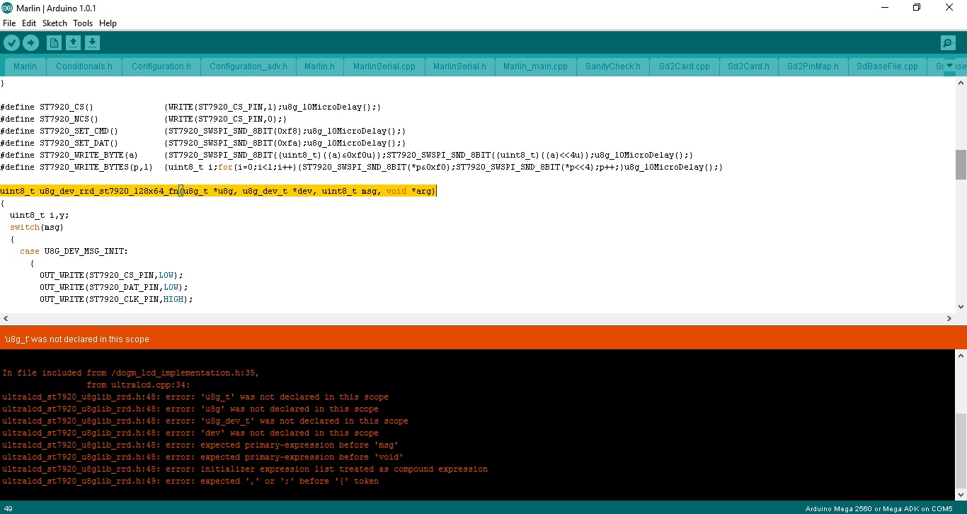

I have a 3D printer PI3A Pro and I suspect its Z axis is reversed, because when I send it to origin (and Z home consecutively), it goes up instead down.
So I tried to change it on the firmware, for that,
I'm utilizing Arduino 1.0.1 and downloaded the following firmwares:
http://www.dropbox.com/s/yzjqw8u6gk9ys9 ... s.jpg?dl=0
- I3A Pro
PI3A Pro(for the upgraded kit using lead screw)
- PI3A_Pro_Firmware_Errors.jpg (214.87 KiB) Viewed 22561 times
Re: Firmware for geeetech 3D printers
Hi,Mako wrote:Hi,
and both of them are appointing the same erros when verifying, even before any change and after importing U8glib library.
- I3A Pro

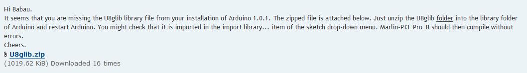

Have you read this post? Download the file and retry it.
