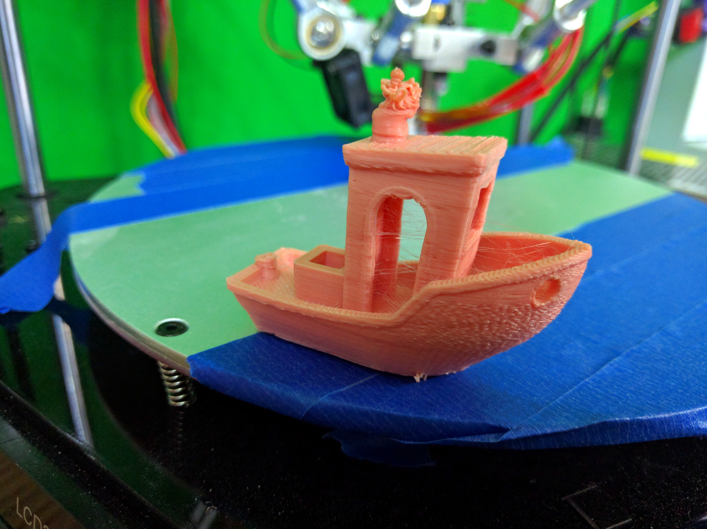

I found it! in the firmware, under Configuration_adv.h, there is a setting called DEFAULT_STEPPER_DEACTIVATE_TIME that was set to 60 for some reason. I dont remember changing it, so I have no idea what happened.
I set to to 0. All is good now and I just finished printing my first benchy.
Thanks for your help!
