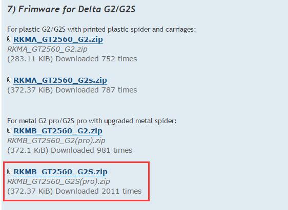

I used the correct version of the firmware for my G2S Pro.
The temperature of the extruder and heat bed were both 0.
