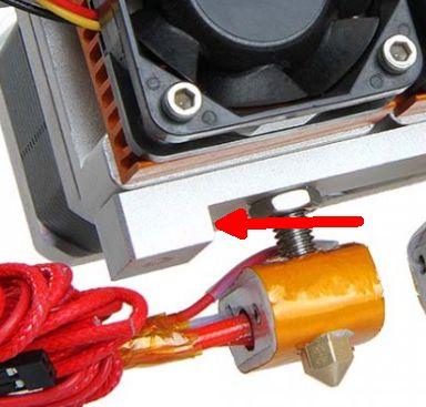

i try to assemble my new Prusa i3 Pro C Dual Head.
When I mount the pre-assembled extruder on the extruder support
the hot-end touches the screws of the extruder holder as seen in picture 1
so i cant fixing the extruder screw in the first hole
Picture 1
Hot End touch Screw
Hot End touch Screw

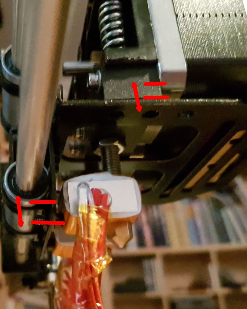

I'I think the problem is, that the extruder has been changed and is now no longer high enough
Picture 2
Trouble 02.jpg (129.93 KiB) Viewed 5776 times

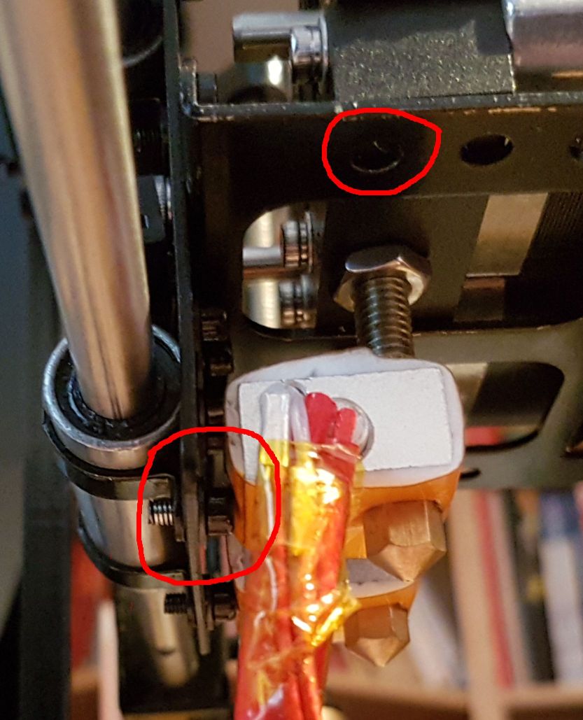

Picture 3
Trouble 03.jpg (27.81 KiB) Viewed 5776 times
Or have I done something wrong..?

I think that you have to fix the X axis plate first.
Then fix the the support plate for the extruder.
Finally, fix the extruder, to the support plate. In my case, as it was too close to the x axis plate, I fixed it to the second hole (there are three holes to choose).
Of course, there is an interference. For the case you want to remove the x axis plate, it is necessary to remove the extruder first.
