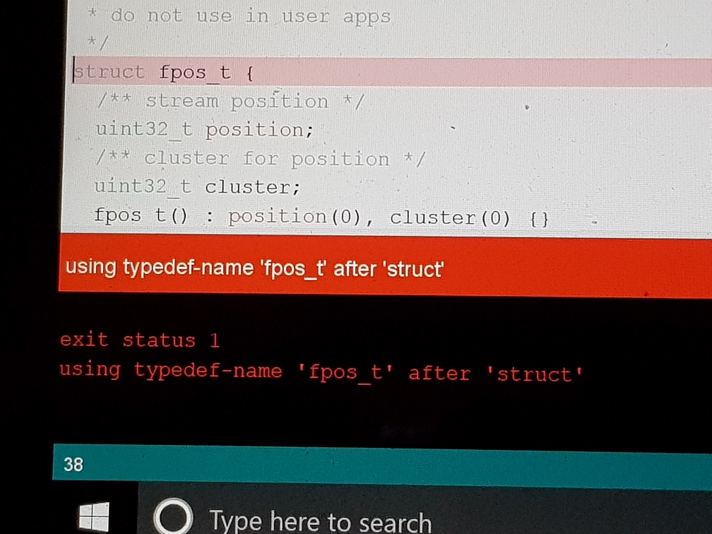

i tried to upload the new firmware when i uploaded it i got a screaching noise and 2 block lines on my LCD
i tried to upload the file again, i have double checked its the right file i have toe geeetech prusa I3 PRO I used the firmware in section 5 of your firmware list
I HAVE AN ERROR EACH TIME I TRY TO LOAD FIRMWARE
I have attached a pic of the error i get
thanks for any help in advance
Chris

- THIS IS THE ERROR I GET
- 20170513_224630[54].jpg (230.83 KiB) Viewed 15215 times

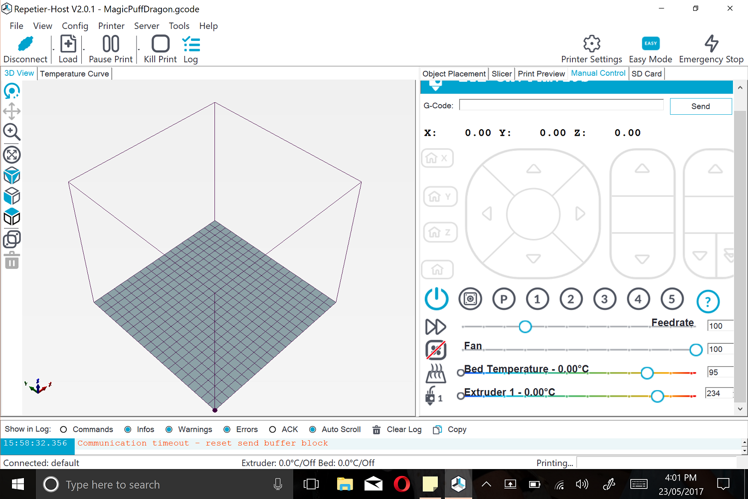

I have managed to get the firmware uploaded the screen is now working correctly and no screaching
the problem i now have is that when i connect to the printer using the repetier software the connection button says its connected to printer but i cant control anything from the software, also i manage to manually can move all the axis from the lcd screen i can also heat up the bed manually.
but it wont print from the sd card or from the repetier software
what have i dont wrong and how do i fix this ?
thanks
Chris
thanks
Chris
Re: Firmware Error
Hi,I think you can reinstall the lastest version of Repetier Host to try again,and here is the download link:https://www.repetier.com/download-now/.Besides,changing the usb cable may make it work by Repeiter.
As to the SD printing,here are some tips for this case:
1、Use repetier to put files on SD-card and the G-codes have been also in root directory of SD-card.
2、Check your lcd and cable,make sure they have a good connetion.
3、Try to use some high end SD cards.
4、Reinstall the FTDI drivers.
Hope this can help.
Hope this can help.

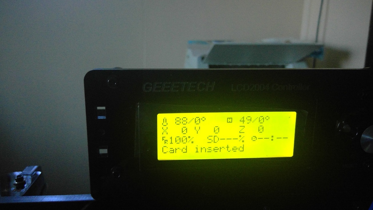

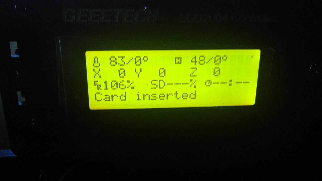

Master Chris
- Posts: 13
- Joined: Wed May 10, 2017 7:25 pm
Re: Firmware Error

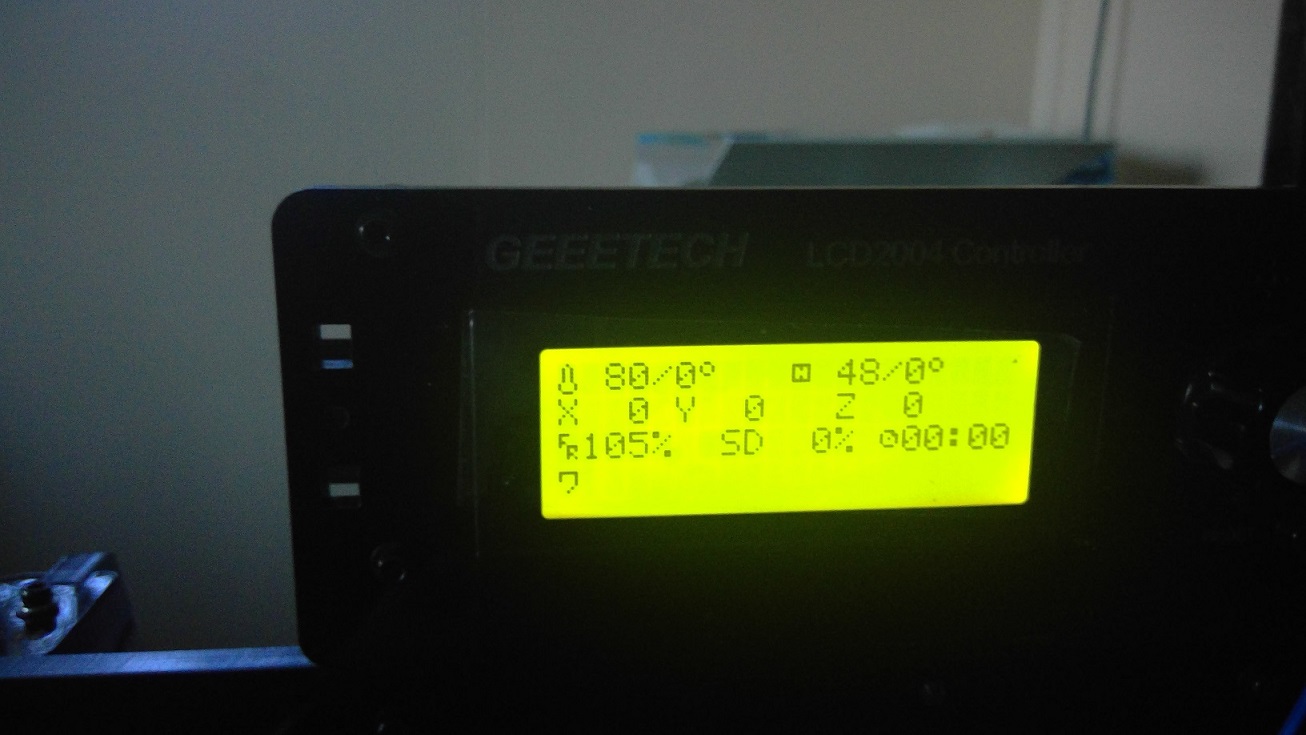

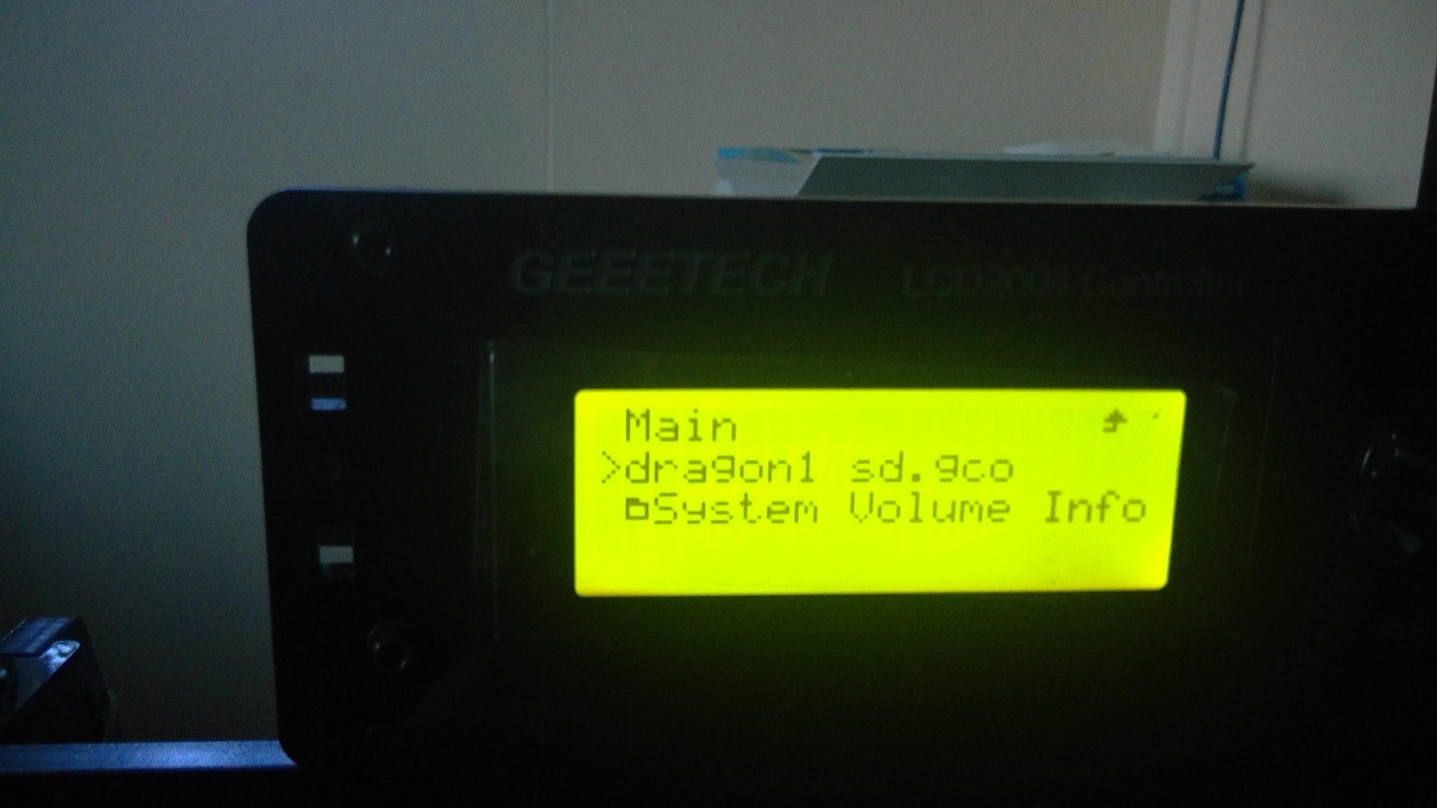

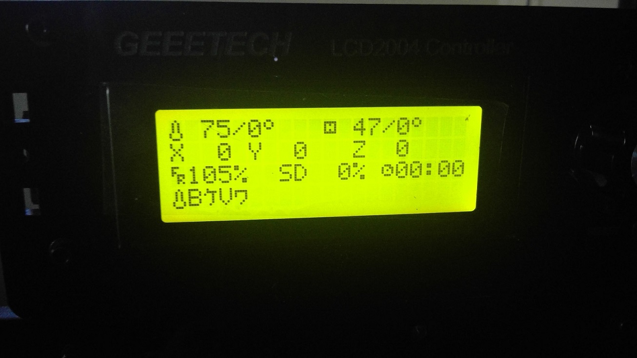

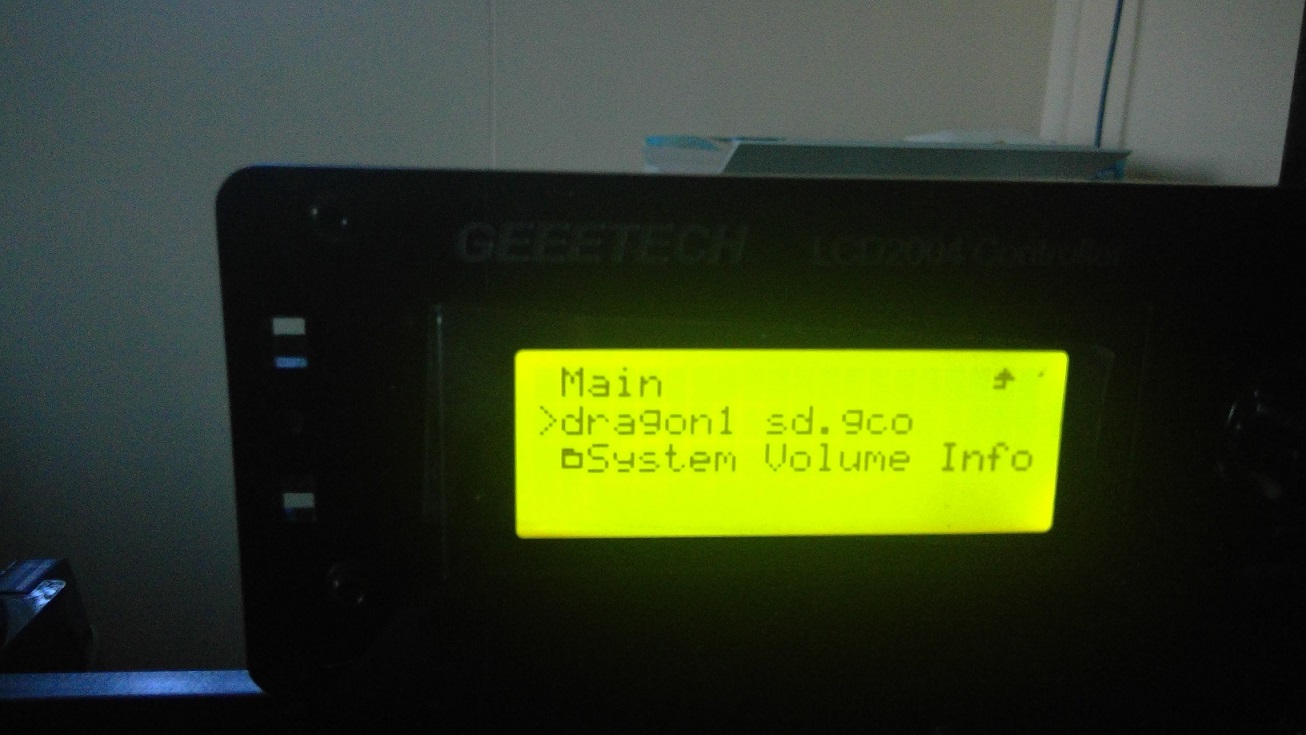

these are the messages im getting when i try to print dont take3 any notice of the temps i did that manually and it was still cooling down
I can move all the xyze through the lcd switch manually but i cant get it to print from either the reipieter software or through SD card the message i get as you can see from the pics is it the count timer goes up when i set it to print from sd but that is all
any help would be apreciated i have tried to change baud rate makes no difference
thanks
chris
thanks
chris
- WIN_20170523_16_04_35_Pro.jpg (200.92 KiB) Viewed 15092 times
- WIN_20170523_16_03_57_Pro.jpg (228.57 KiB) Viewed 15092 times
- WIN_20170523_16_03_50_Pro.jpg (216.3 KiB) Viewed 15092 times
- WIN_20170523_16_03_50_Pro (2).jpg (254.75 KiB) Viewed 15092 times
- WIN_20170523_16_03_40_Pro.jpg (199.55 KiB) Viewed 15092 times
eddiesomesan
- Posts: 2
- Joined: Tue May 09, 2017 3:13 am
Re: Firmware Error
Change the USB cable. Try to use a good quality one and as short as possible. I had some similar issues...it was stopping in the middle of the print showing that communication error. The problem was the cable which was too long.
Master Chris
- Posts: 13
Re: Firmware Error
Hi Guys
Thanks to everyone for there input i have managed to resolve my problems and I am printing again with some good results.
ABS filament that im using is a bitch to get the settings right but im getting there
thanks again
Chris
