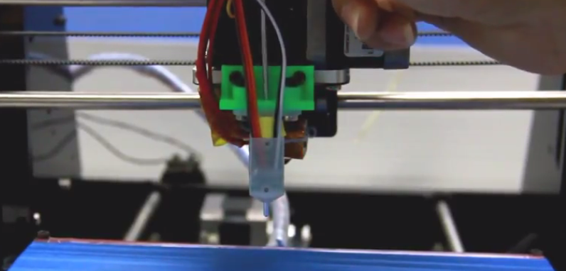

Re: 3dTouch problem
After watching this video,I think it's because the magnet at the top of the probe is short of magnetic force.So here are some tips for you.mgros wrote:you can see the accidental deploy at second 9.
https://youtu.be/5Jmm46Bd0LM
The pin fall, touch the bet and not go up.
Thanks for your help.
1、Change a new probe,especially the magnet inside the sensor;
2、Adjust the screw on the top of the sensor a little higher,like the picture showing.
