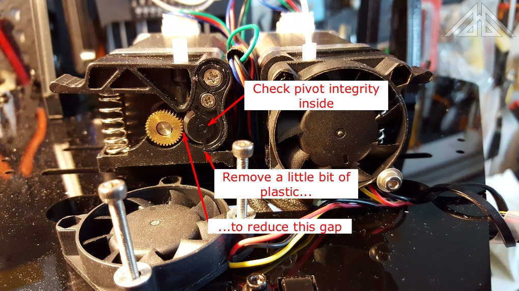

I upload this firmware, but now I can't actualice the firmware and EasyPrint3D program show a window that said unknown device.
And the extruder flow isn't enough, the filament extruded is so thiny
How I can solve this issue?

Re: Firmware request Prusa Mendel I3 with MK8 Extruder
There are some wrong in the extruder, specifically in the screw that pushes the filament which slides when pushing plastic because it does not have enough pressure.
The solution was as easy as putting a piece of paper in the extruder's spring, so that it becomes stronger and the filament does not slip when it passes through the screw.
- 出料不够改进图.jpg (485.25 KiB) Viewed 8579 times
