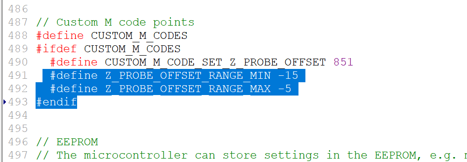

Maybe you should check the configuration.h in these lines
You should ensure Z-offset value is under this range

Re: GeeeTech Rostock Mini G2S Pro Concave Offset
You should set the value to -5 to 15 and recalibrate
