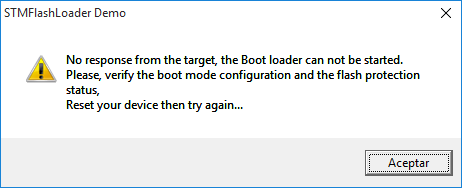

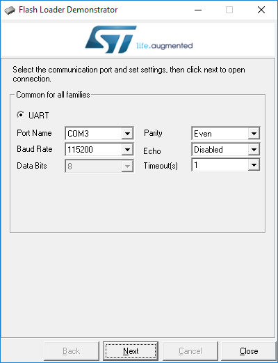

Hi.
Buy a Rostock 301, I put it together but it does not work. Contact the seller and he told me that I have to install the Firmware (I pass this page).
I want to do it but I receive the following error:
STMFlashLoader Demo
No response from the target, the Boot loader can not be started.
Please, verify the boot mode configuration and the flash protection status,
Reset your device then try again...
Aceptar
Could you help me?
Thank you very much,
Regards
STMFlashLoader Demo
Aceptar
Could you help me?
Regards

Re: How to burn the firmware for GTM32 Pro VB
Have you tried to add the jumper cap to boot0?DarkSylver wrote: Sun Mar 11, 2018 12:55 am Hi.
STMFlashLoader Demo
Aceptar
Could you help me?
Regards

Hi.
Yes. I put the Jumper, connect the USB and reset the board. But he does not detect it.
Regards
Could you find the mainboard USB port info at the device manager of your PC?DarkSylver wrote: Mon Mar 12, 2018 10:58 pmHi.William wrote: Mon Mar 12, 2018 7:08 pmHave you tried to add the jumper cap to boot0?DarkSylver wrote: Sun Mar 11, 2018 12:55 am Hi.
STMFlashLoader Demo
Aceptar
Could you help me?
Regards
Regards
If you can't find it, seems the mainboard was broken
The issue of a properly installed FTDI chip driver remains to be clarified.
And in our controller's board, after the proper activation of the bootloader, the LED indicator lights up. I do not know how it is in your printer version.
