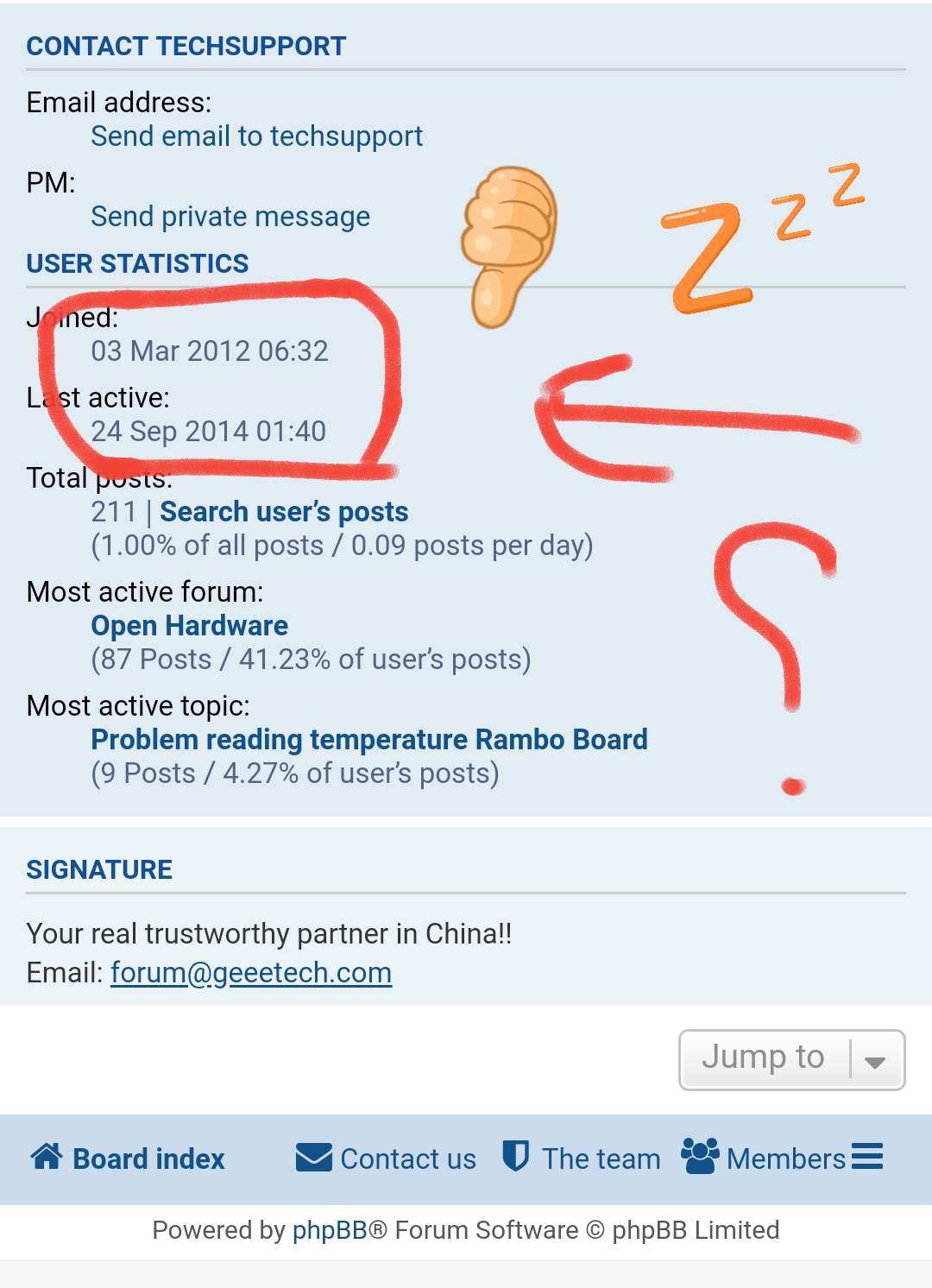

Bad after-sales service 04/01/2004 to 2018
