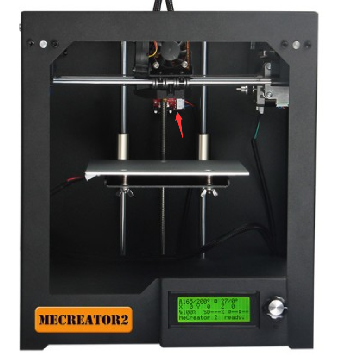

Hi,you can adjust the position of the Z axis’s entstop according to you actual sitution.Here is the picture showing.
- Mecreator2 endstop.png (167.62 KiB) Viewed 18321 times
Re: Glass Plate on the Mecreator 2
Thank you, I adjust the switch now.

How do you do it .. the switch if fixed to back and no adjustment screws are seen

You can just print a spacer so that it touches the endstop first.
https://www.thingiverse.com/thing:2017642
