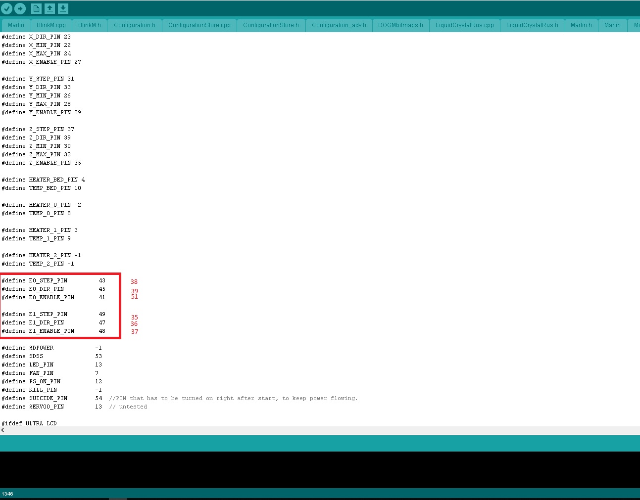

Hi.
I want E0 to use pin for E1 and pin for E1 use pin for E0. I suspect E0 pin command has a problem inside ATMEGA2560.
How do I edit the code?
Thank.

pcomud
Posts: 8
Joined: Wed May 30, 2018 8:06 pm
Re: Extruder not pulse
Post by pcomud »
Gingko wrote: Fri Jul 27, 2018 5:20 pm It should be mentioned that the extruder only works when it heats up to over 170 degrees.
If you want to use E1 slot, refer to this post:
viewtopic.php?f=20&t=18020
Hi Gingko
I use a multimeter on my GT2560 board, it does not match any pin at all. Show on the attached picture red text is the pin that I measured.
Thank.
My GT2560 board for I3pro W.jpg (172.58 KiB) Viewed 7567 times
My pin for GT2560 I3pro W.jpg (148.74 KiB) Viewed 7567 times
