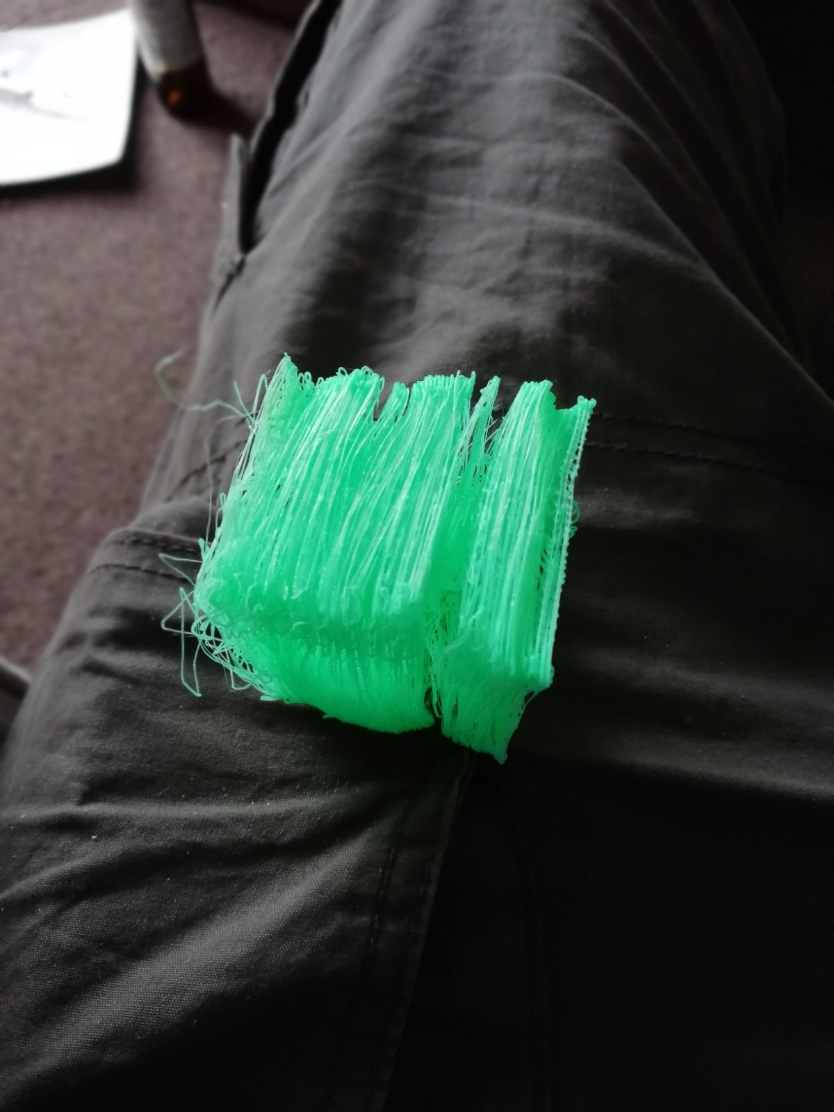

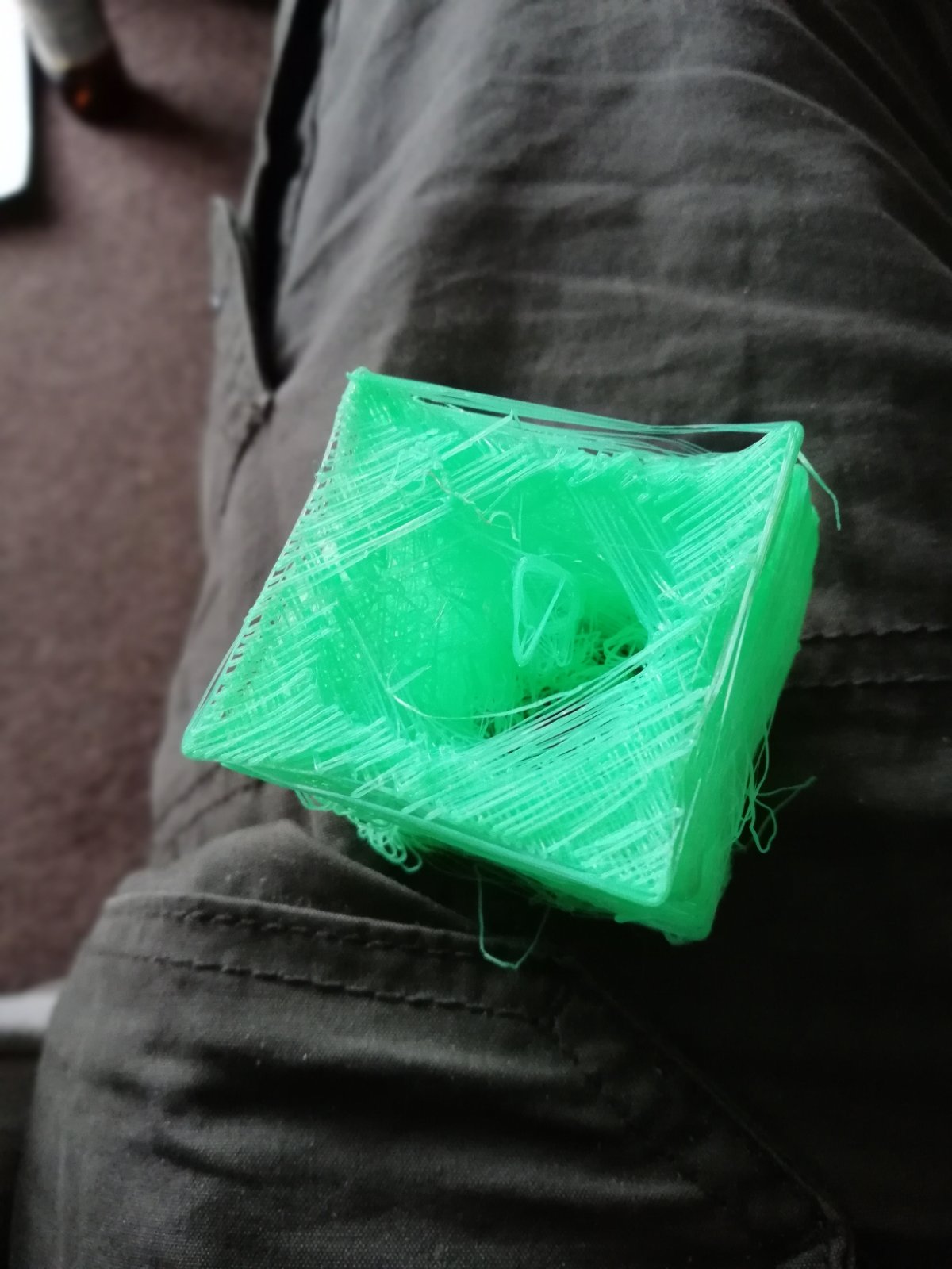

I am new to 3D printing, and thought the assembly would be more difficult than actually printing. I have completed my first item but it is falling apart and looks ver stringy. I think it could either be the Filament is not getting hot enough or the slicer I am using is not correct. If I am totally wrong please can you direct me in the direction of the truth. Please see sample of issues.

I have tried increasing the feedrate, from 100 to 204 this is how I got this result. Something's I have noticed my z axis when I home it, it goes up about 0.5m but not down to the stop switch. Also I have tried using STL files from thingiverse and tinkercad.

You need to adjust the stepper mm of Z axis(Your printer z axis rod it T8)
http://www.geeetech.com/forum/viewtopic ... 20&t=17046
