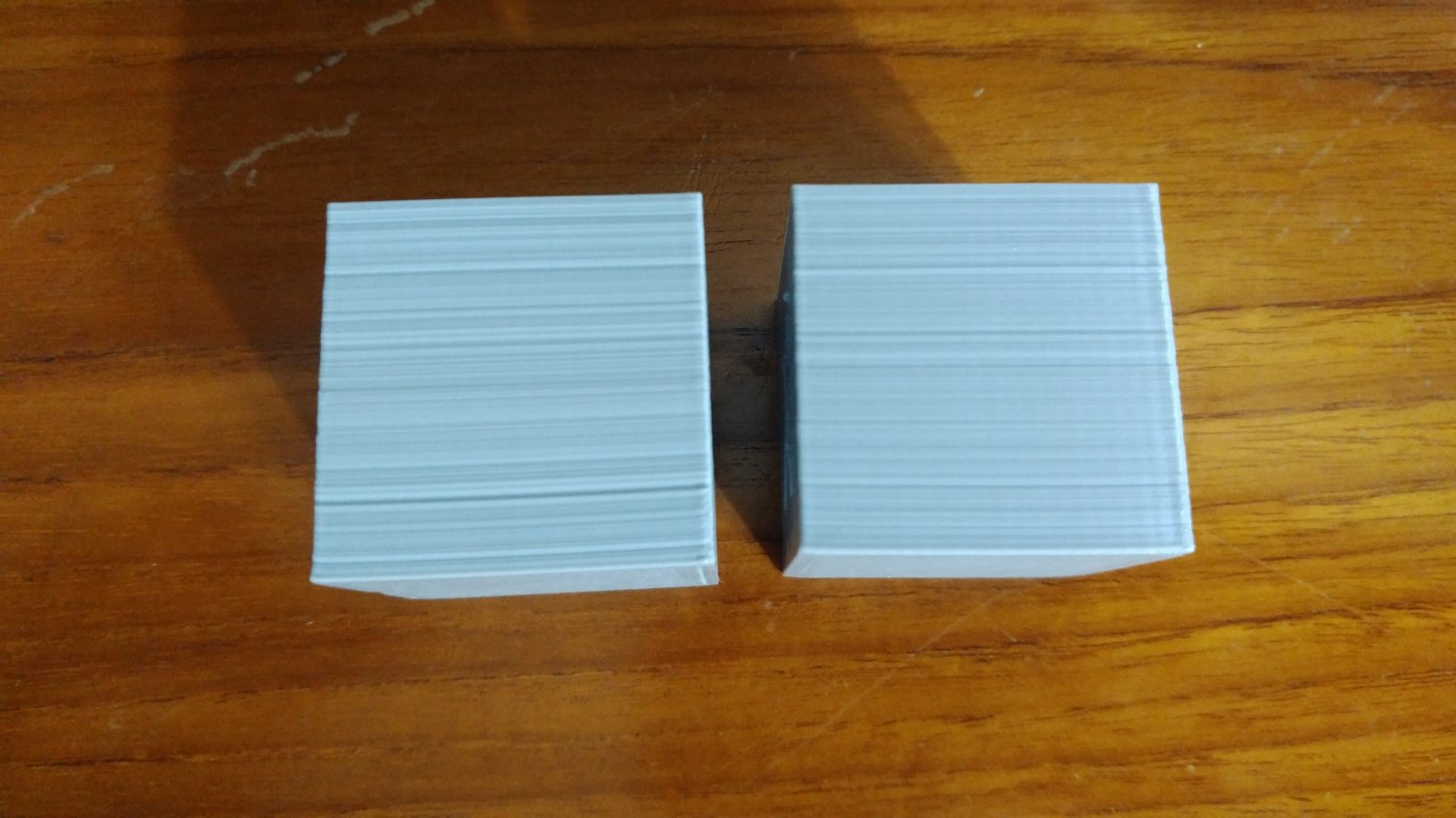

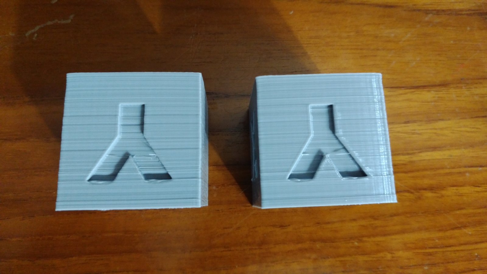

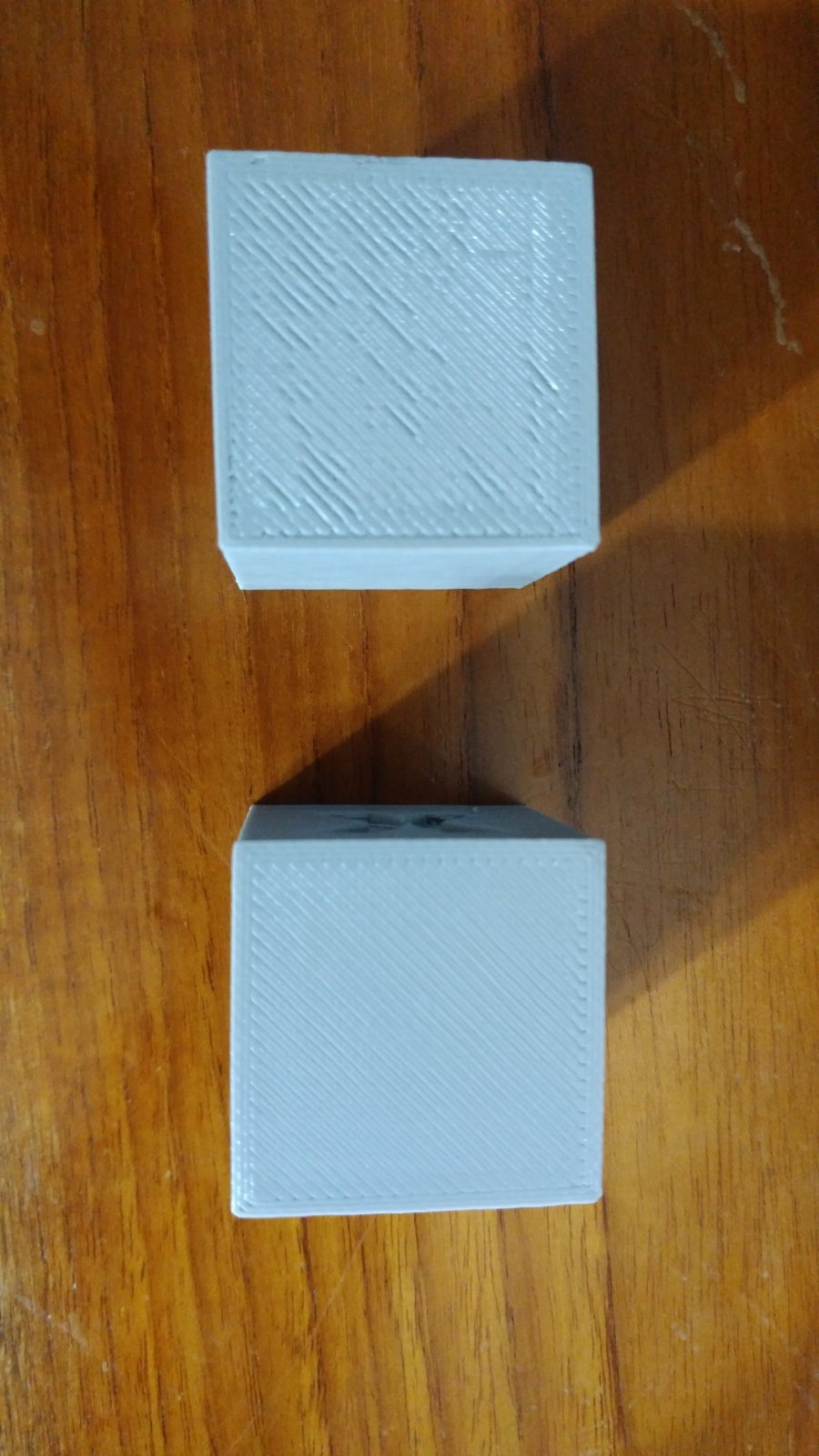

I printed these last night and put one on my X axis belt.
https://www.thingiverse.com/thing:10082
I scaled the Z axis up only by 20% a few times to make some of different sizes. It tightened the belt and helped quite a bit. Surprisingly on the bottom infill as well. Probably needs a bit more however as it's still not quite there.
2018-09-18 07.19.39.jpg (167.31 KiB) Viewed 12045 times
2018-09-18 07.20.09.jpg (161.17 KiB) Viewed 12045 times
Bottom of cube before and after

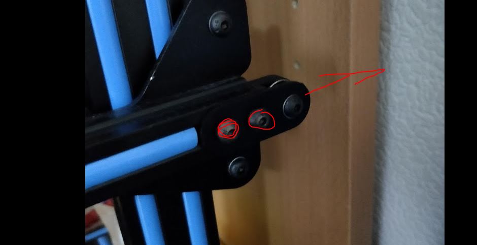

loosen the screws, pull the axe, hold it tight, fasten the screws
