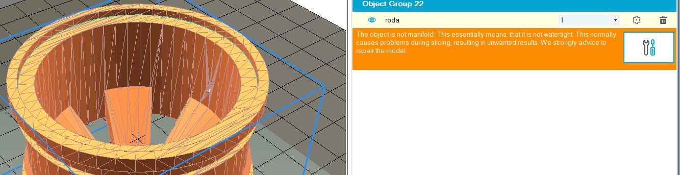

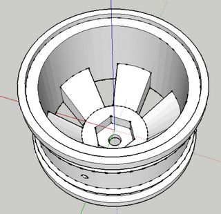

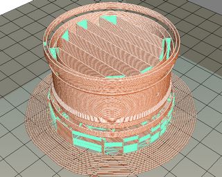

I use SketchUp 8.0, to design a RC wheel, export as .STL and .OBJ.
Import to Repetier Host and Slice with CuraEngine.

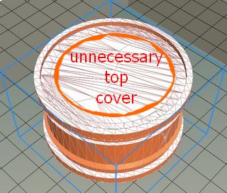

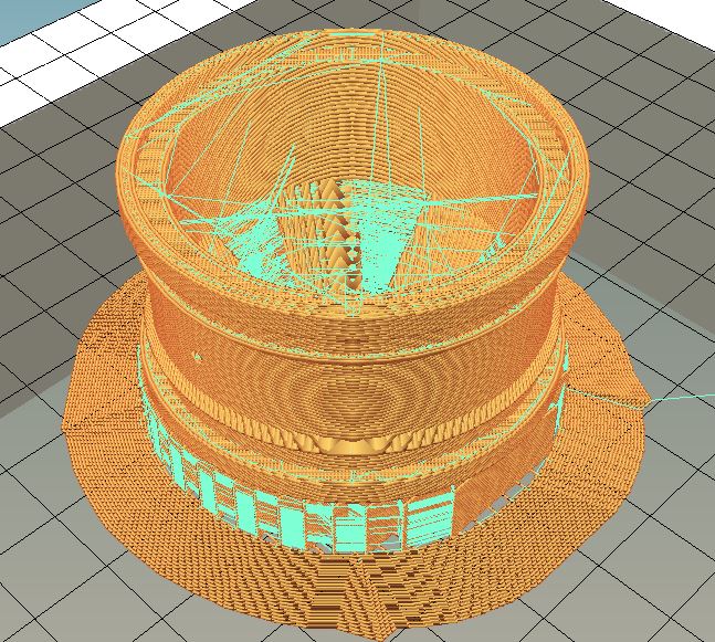

After repair the object, the wheel show a top cover.
How remove or not print this unnecessary top cover?

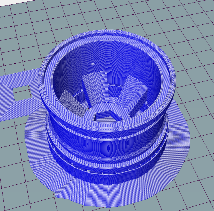

I try mark "Spiralize contour", not work.
Someone can help-me?
Best regards.

The message showed is: Than I try slice without repair.
Not work.
Not work.

Would you agree to share your model with us before repair?
I will see what can be done.

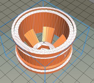

Check it out now.

Wow!
Perfect! What it's mistery?

I imported in Tinkercad, set the position to the grid, and did the export.
Sometimes I ignored this message, and printed without repair.
