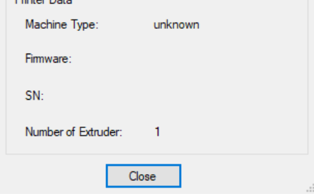

the printer wont connect to windows 10 no matter what , ive got a fair few modelling programs and printing programs but none of them seam to pick up the printer with no errors at all or explanation ,ive browsed the forums and downloaded all the drivers i can
Easy print 3d knows the printer is there but it doesnt know any thing else

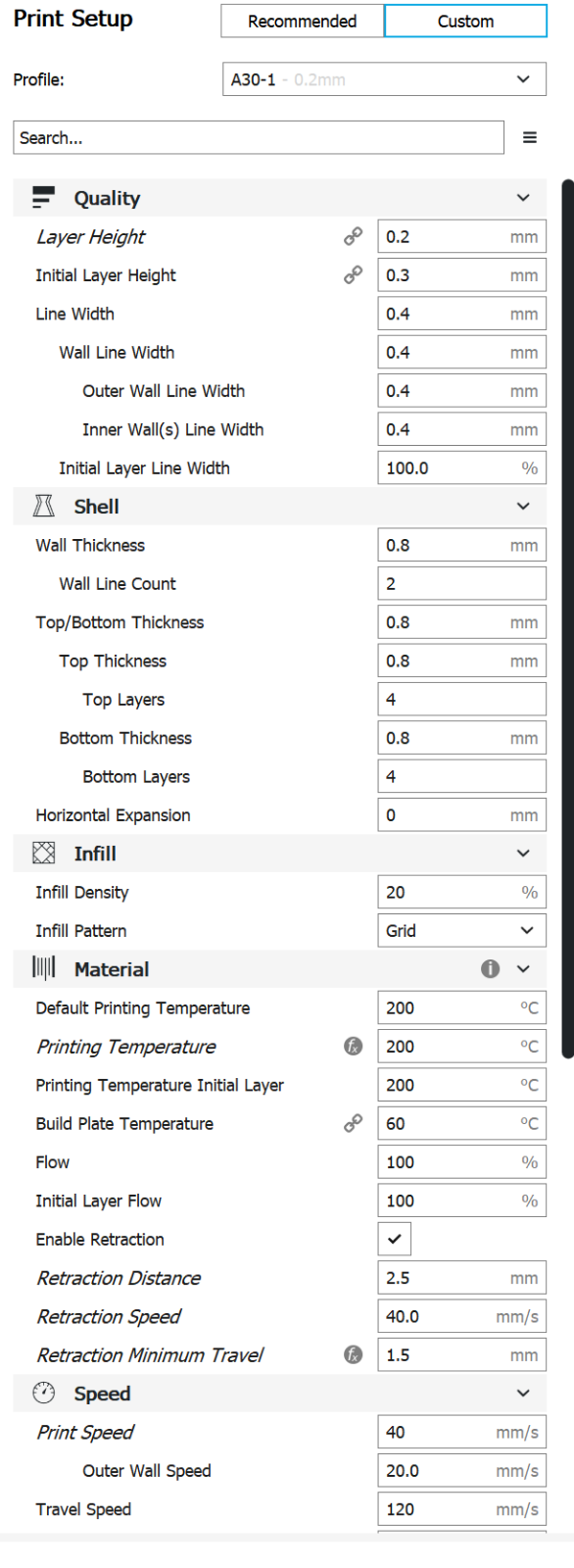

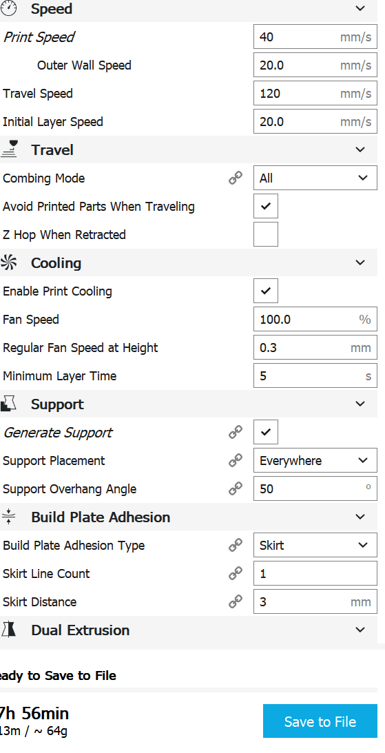

Cura
settings 2.png (42.51 KiB) Viewed 5913 times

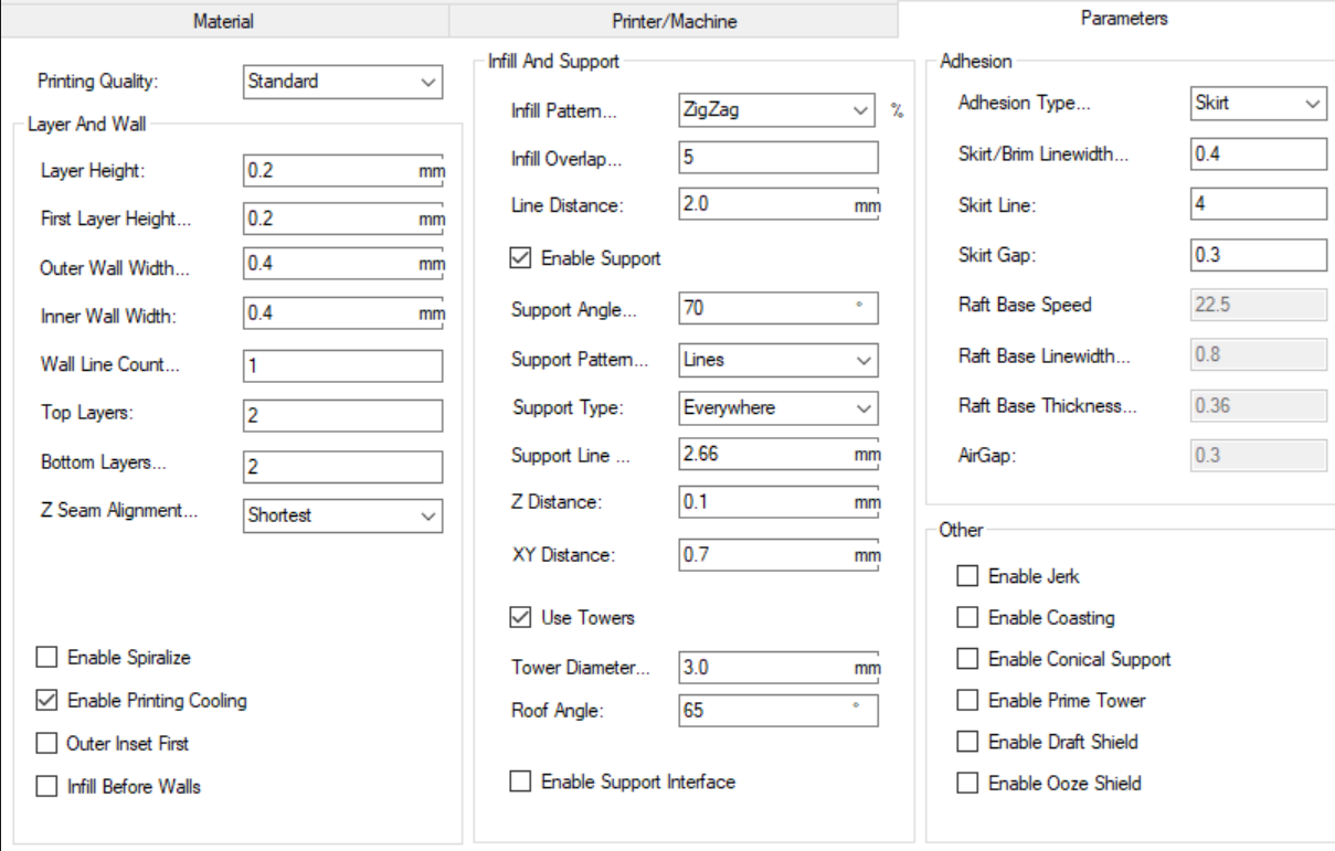

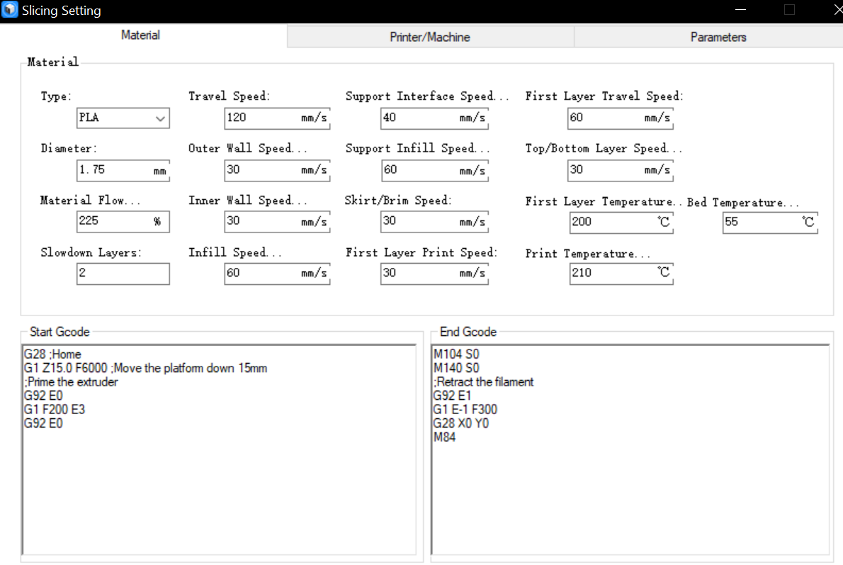

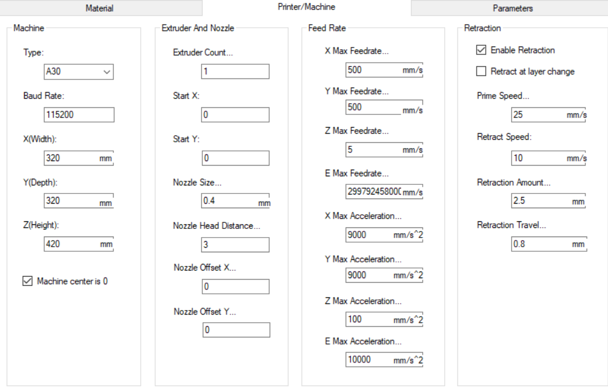

EasyPrint 3d
settings 3.png (71.82 KiB) Viewed 5913 times
settings 4.png (130.96 KiB) Viewed 5913 times
settings 5.png (150.62 KiB) Viewed 5913 times
