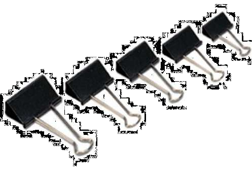

Hello.
If you are using office clips, remove them.

Hi
Thankyou for the reply, im not sure what you mean by office clips.

Re: Printer error at final hurdle
WOW, how could i miss that... your such a big help thankyou so much.. that has solved everything...
best advice EVER!!! glad this is such a helpful forum!!!!
