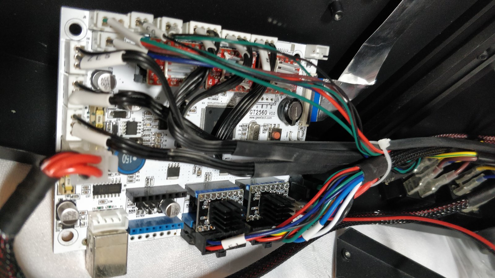

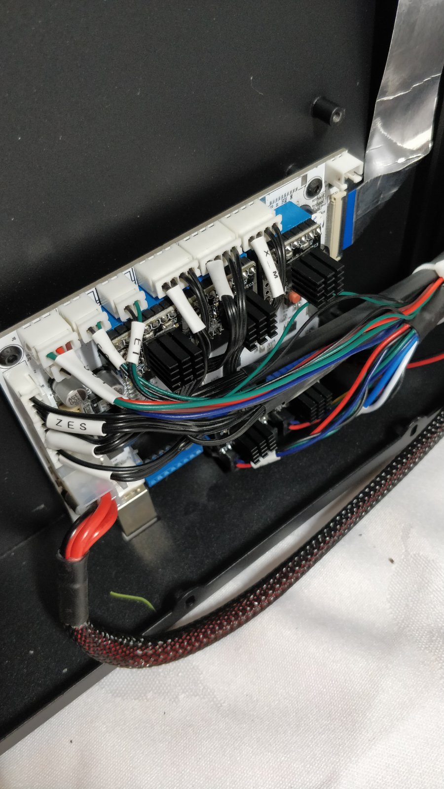

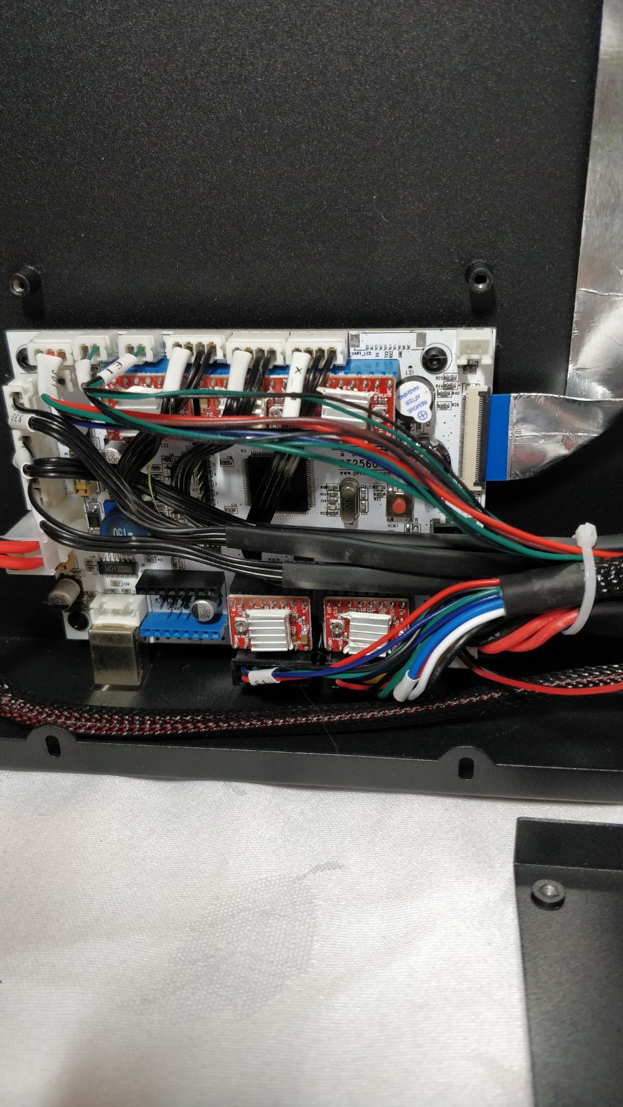

In pictures....
Carefully remove the ribbon cable from clips

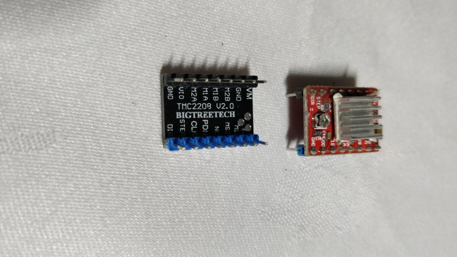

Pay attention to GND pin on old and new drivers
Insert the driver first then only attach the heatsink, it's easier

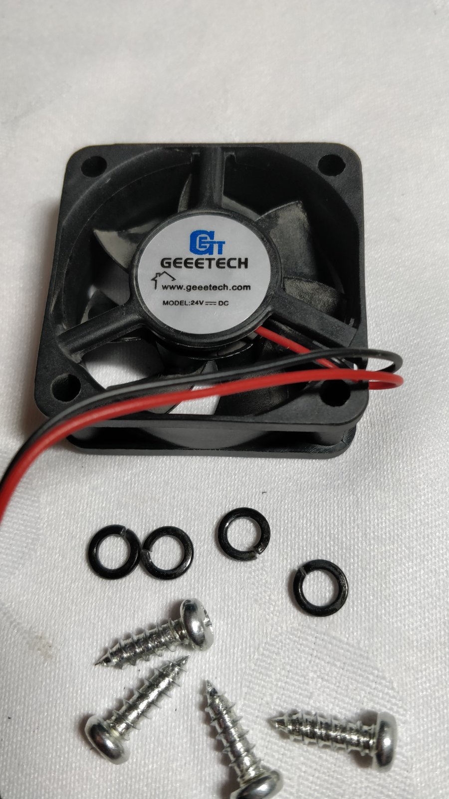

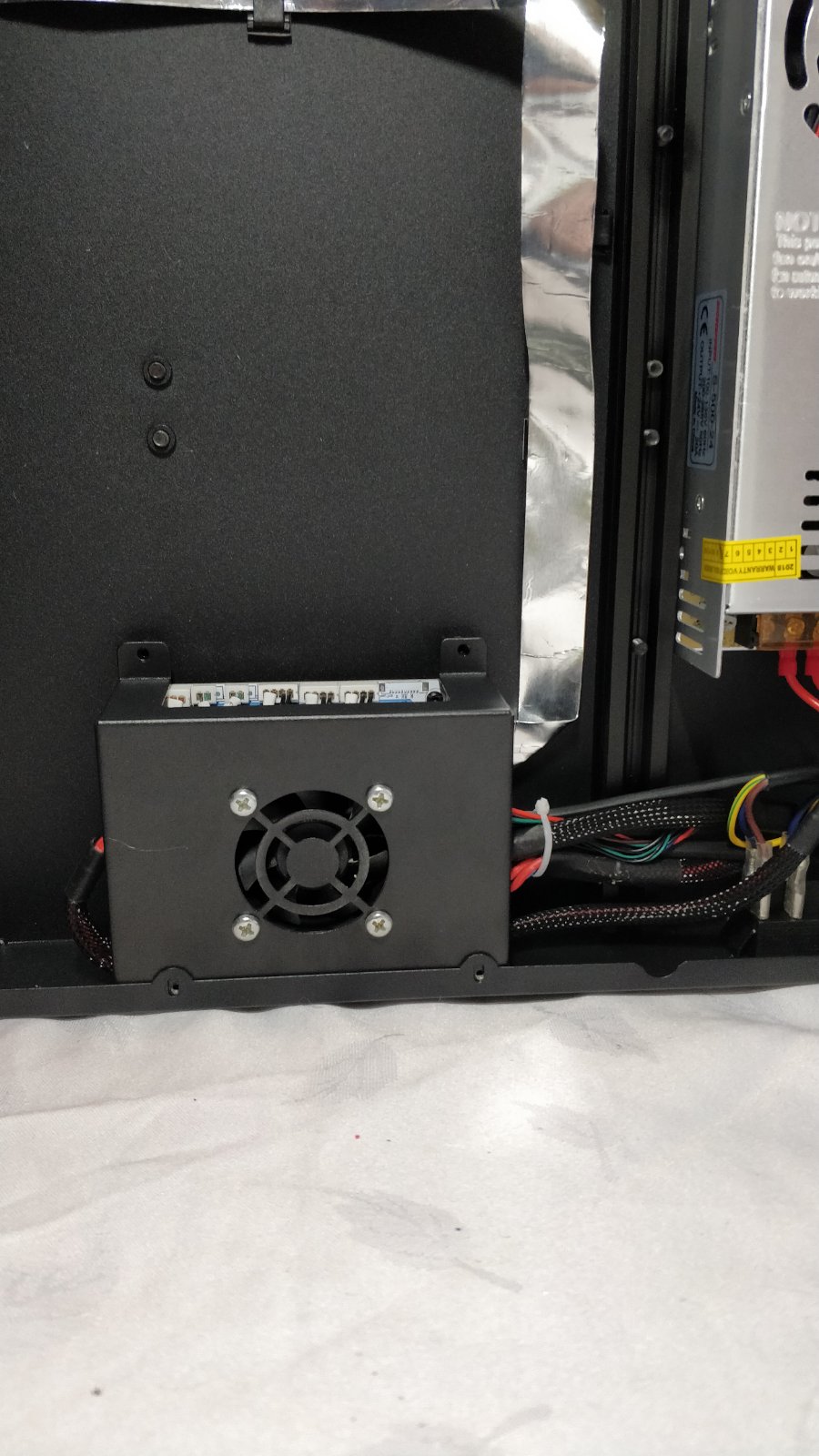

I had to remove the 24V fan because the new drivers have a bigger heatsink so there is not enough clearance for the fan.
unclip ribbon cable and remove 4 screws
View without cover
Close up of factory drivers(note GND pin at bottom)

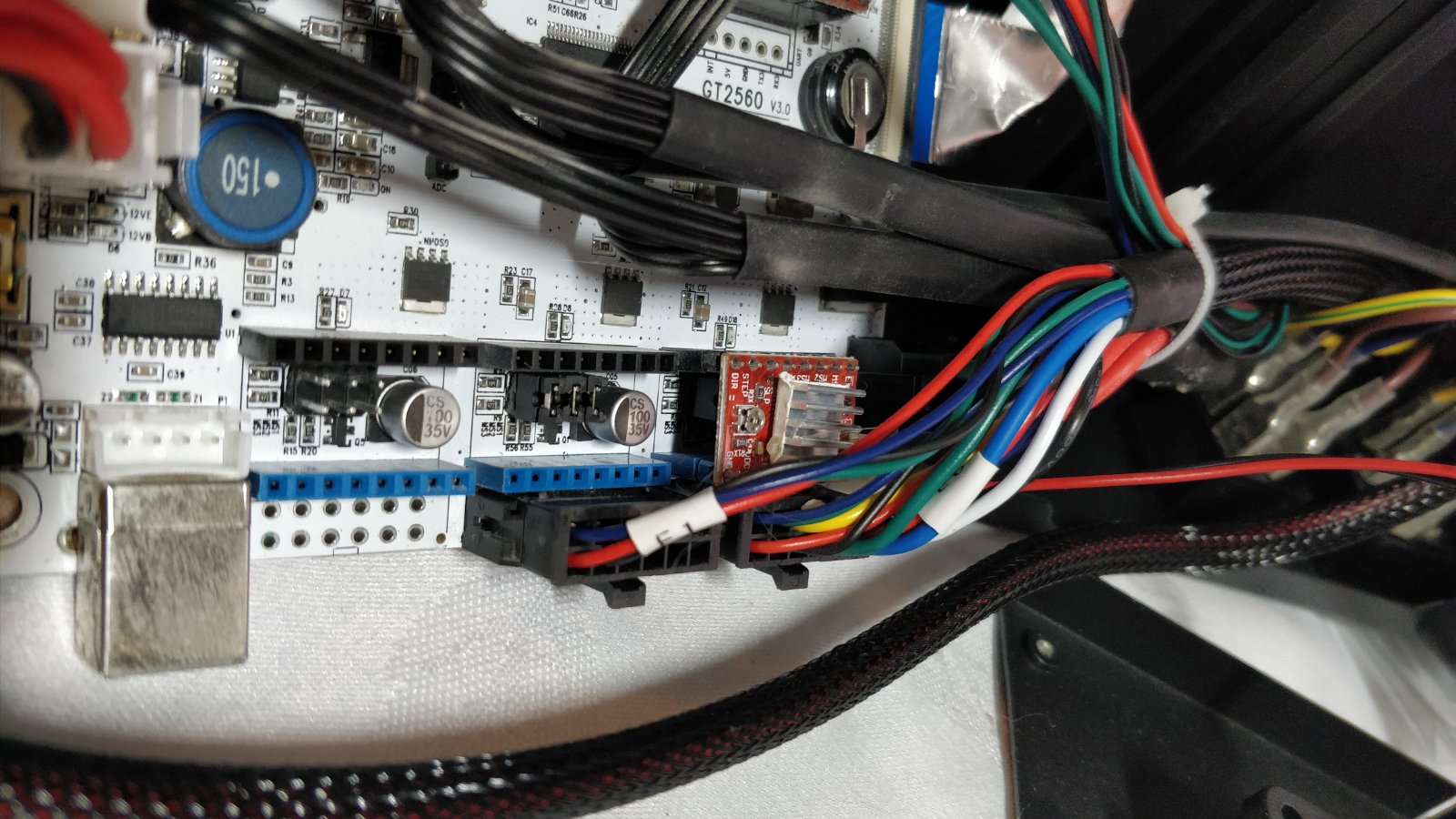

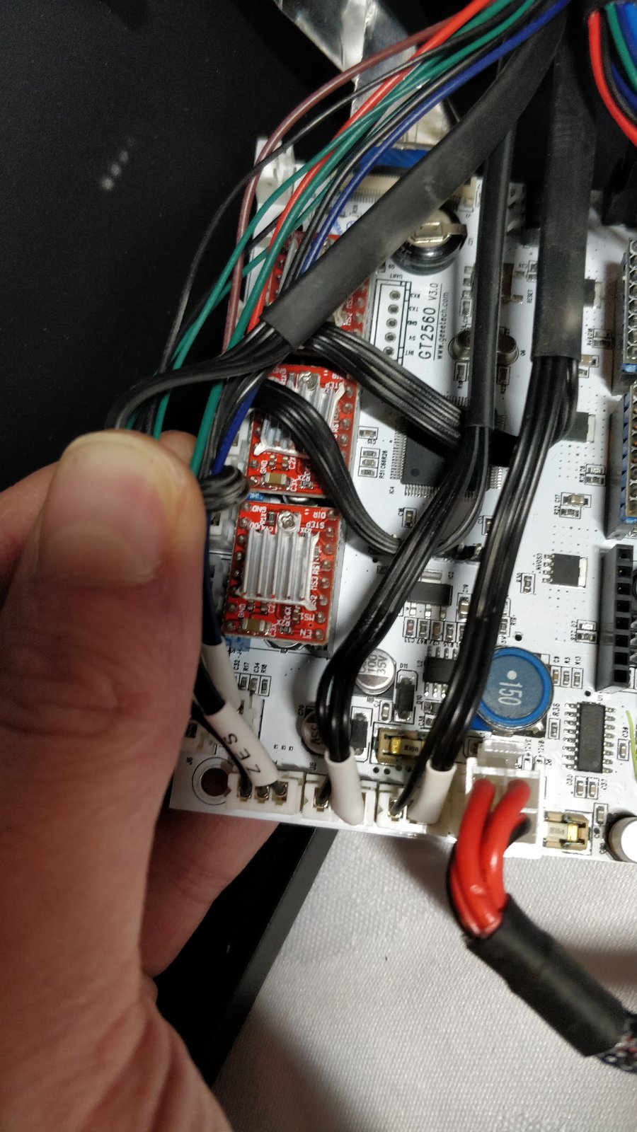

1 driver removed
Check of GND pin location on new and old drivers

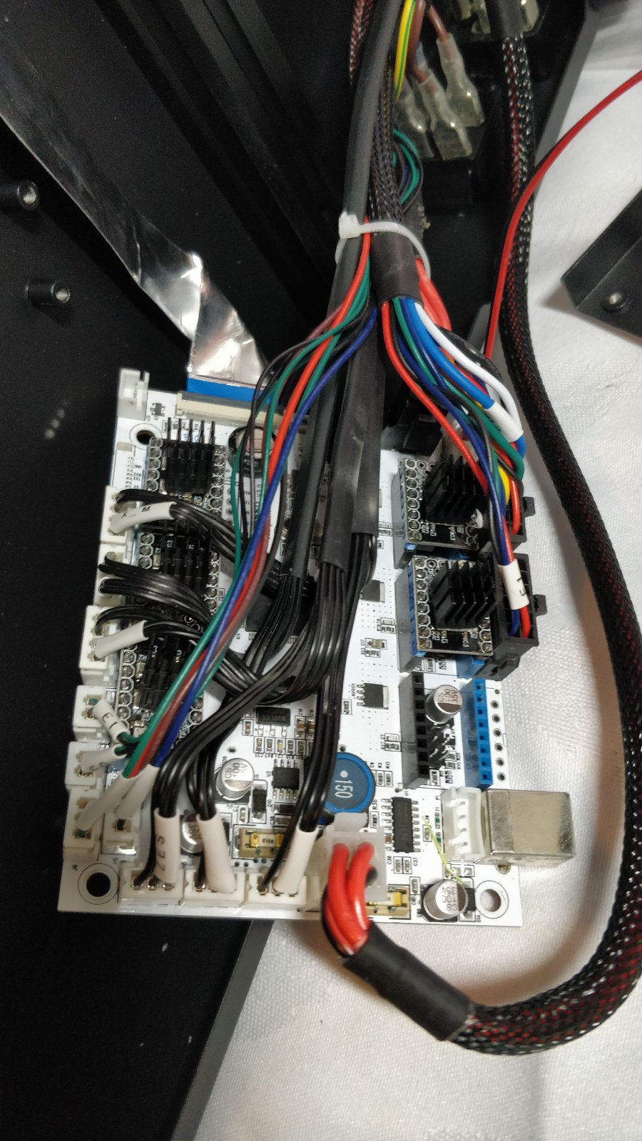

2 new drivers installed
Top rank of drivers have GND at opposite location
All new drivers installed (be carefull that the wires don't push away the heatsink)
Board screwed back in place

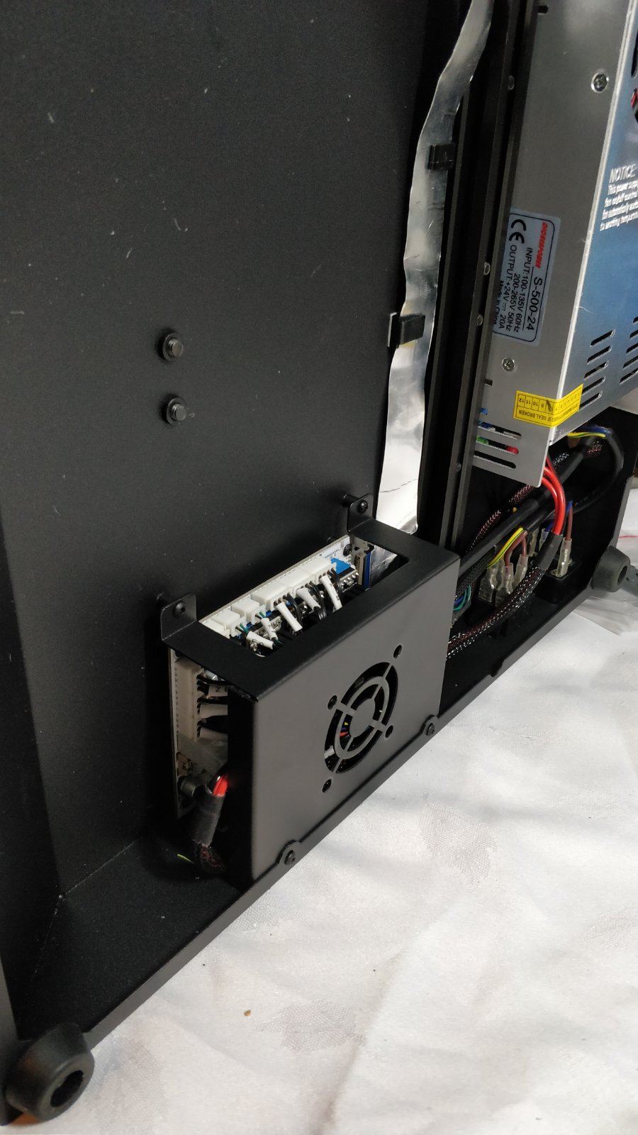

24V fan removed
Cover and ribbon cable back in place

Thanks yesterday I did this process, This is important:
1) The colors of the drivers are changed, you do not have to follow the color model, you have to follow the model of the pins
2) Just change the direction of the engines in Marlin.

Note, if you do not want to get rid of the FAN, I suggest printing this board cover:
https://www.thingiverse.com/thing:3322209
