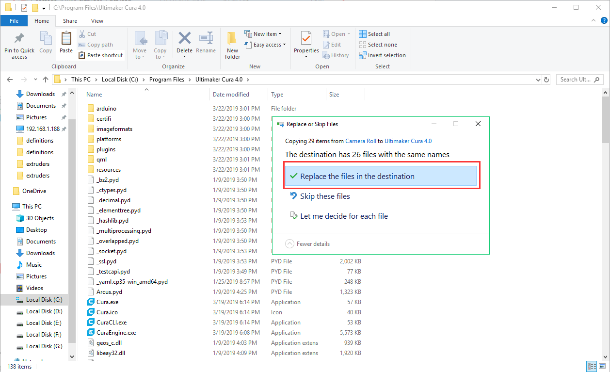

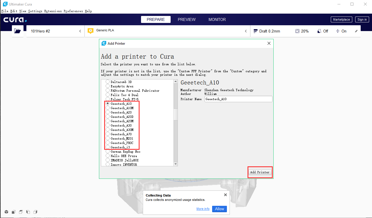

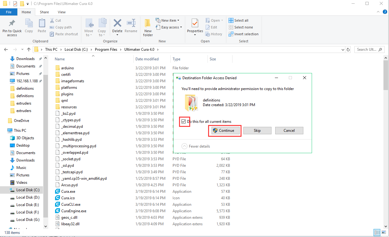

2. Unzip the zip file then you will get "resources"folder
3.Copy "resources" to the
Cura installation directory
Default:
C:\Program Files\Ultimaker Cura 4.0

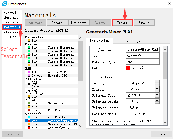

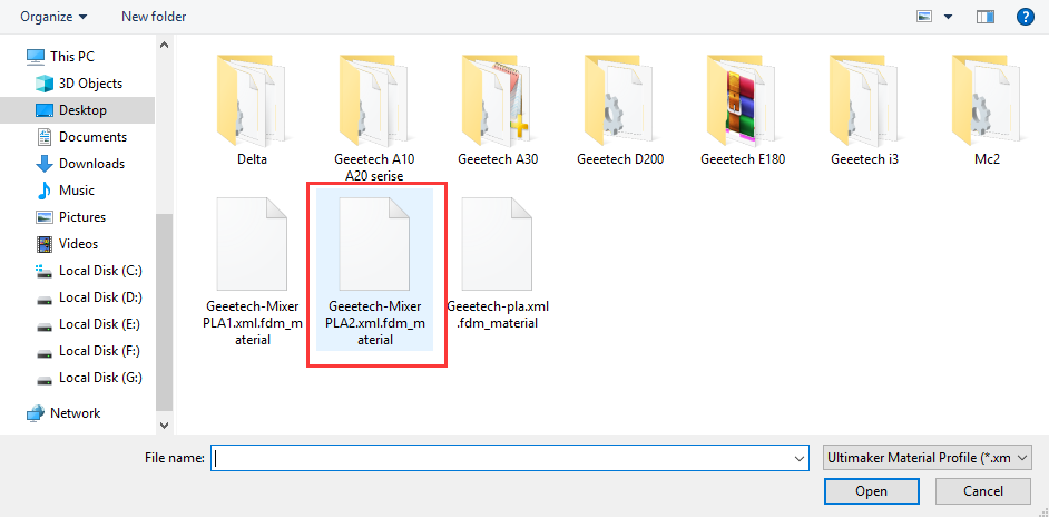

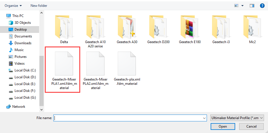

3.Import the PLA filament profile for Geeetech A10M
Filament profile1.png (29.2 KiB) Viewed 40744 times
Filament profile2.png (48.1 KiB) Viewed 40744 times
Filament profile3.png (49.75 KiB) Viewed 40744 times

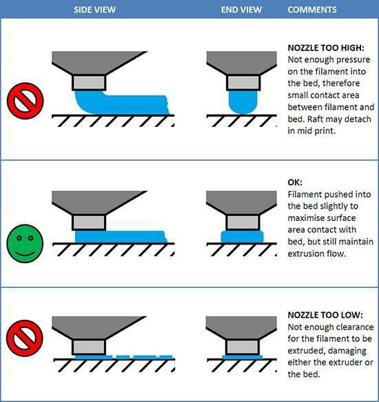

Thanks William for your post and link. I followed your instructions and finally got my new a10m and computer talking. Printing out my first project now. So Far so Good. I am still having an issue with the z axis not being close enough to the bed when it first starts. Any tips?
Re: Cura json file for your Geeetech A10M printer
Hi,@aamulk
You can refer to these
1.Check the heatbed level
Refer to this pic
2.You can use the babystep adjust the z offset when it start print.

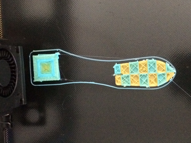

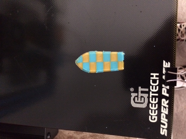

It took a while, but thanks to your JSON file and some dialing in on Cura 3.5, I was able to eliminate my stringing problem and the extruder gear from shaving the filament. I used the two color Benchy for a test since it has some many changes with the two colors. Bleeding was eliminated by significantly increasing the volume of the prime tower. Image
Top View No Stringing
Bottom of Benchy
Bottom of Benchy
