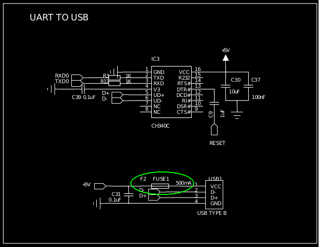

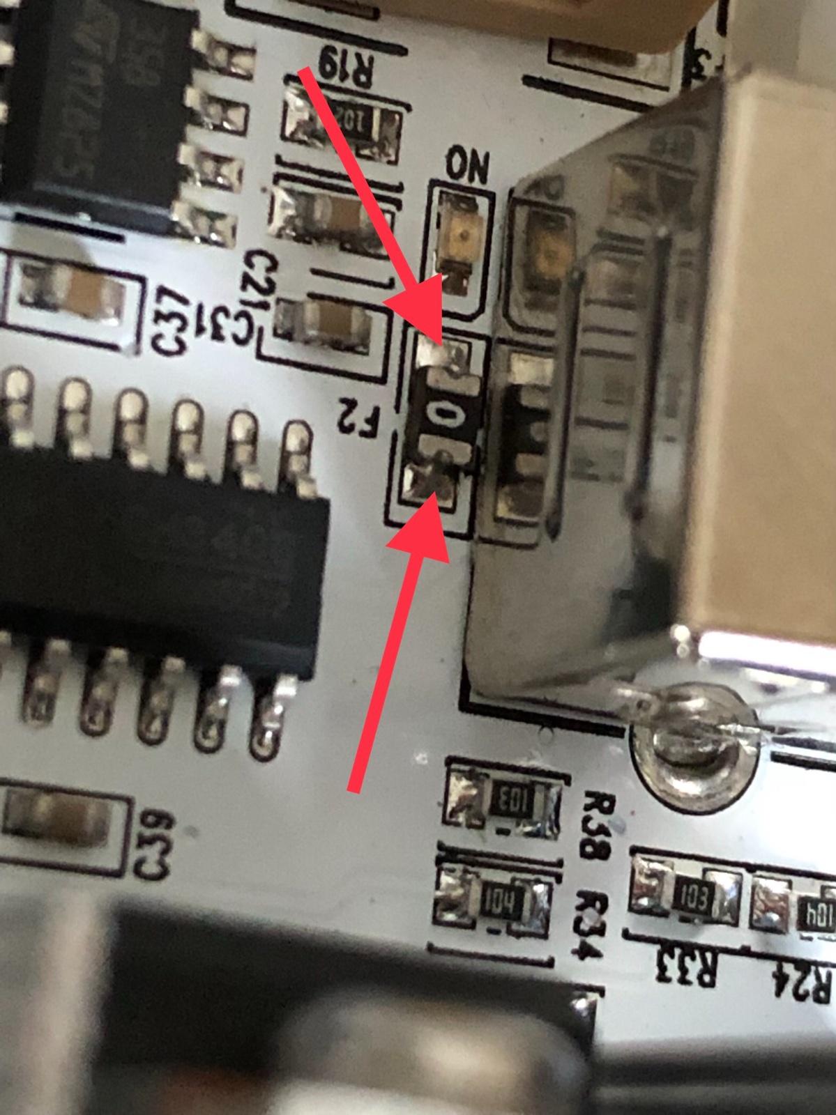

The electronic circuit near the USB port should have a fuse marked F2.
Can you find it :?: You can show a picture with this part of the controller board. :D
Unsoldering it will interrupt the power supply circuit of the controller board from the USB port.
This operation is safe.
It will turn off the automatic power switching between PSU and USB.
This function has already caused many problems for different users.

Is that the F2 Fuse where the arrows are pointing?
If so, I could unsolder it right away.

Yes, the element indicated by arrows. ;)
In your case it is a 0Ω resistor.
