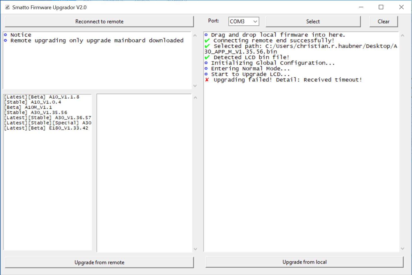

The Problem is, that I`m not able to update/upgrade the firmware (as written) to this version because of a timeout while upgrading LCD. Making a upgrade (also with two steps) is not really a problem BUT if the tools don`t allow this update because of a timeout what will I do?
Second thing is, if I open for example a enclosure of the machine I will loose warranty! This is also written in the "AGB" of Geeetech! In this case I can do nothing expect of pressing a upload button on a non functionable software. I tried two different software tools from Geeetech but It doesn`t work.

Yes, the card is inside. I also tried another one but with no success.
In between I found a video on YouTube. This user uses a smart update tool from GitHub. I tried this and I succeeded BUT anyway, it is not possible to heat the nozzle. It shows the right actual temperature but doesn‘t heat up.

So I have to say thank you for the help. With you and the forum I found the issue on the heating element. After I got this new printer and started up in between 2 minutes it get`s broken. Anyway I changed the heating element (24V/40W/~15Ohm) and it works.
The Solution for the Firmwareproblem is to download the "smartto firmware tool":
https://github.com/Geeetech3D/Smartto-T ... plications
And the actual Firmware:
http://www.geeetech.com/firmware/
First download the Mainboard => After update RESTART manually!! => Let the updater start to update the board
Then download the Panel => After update RESTART manually!! => The Panel starts to update
