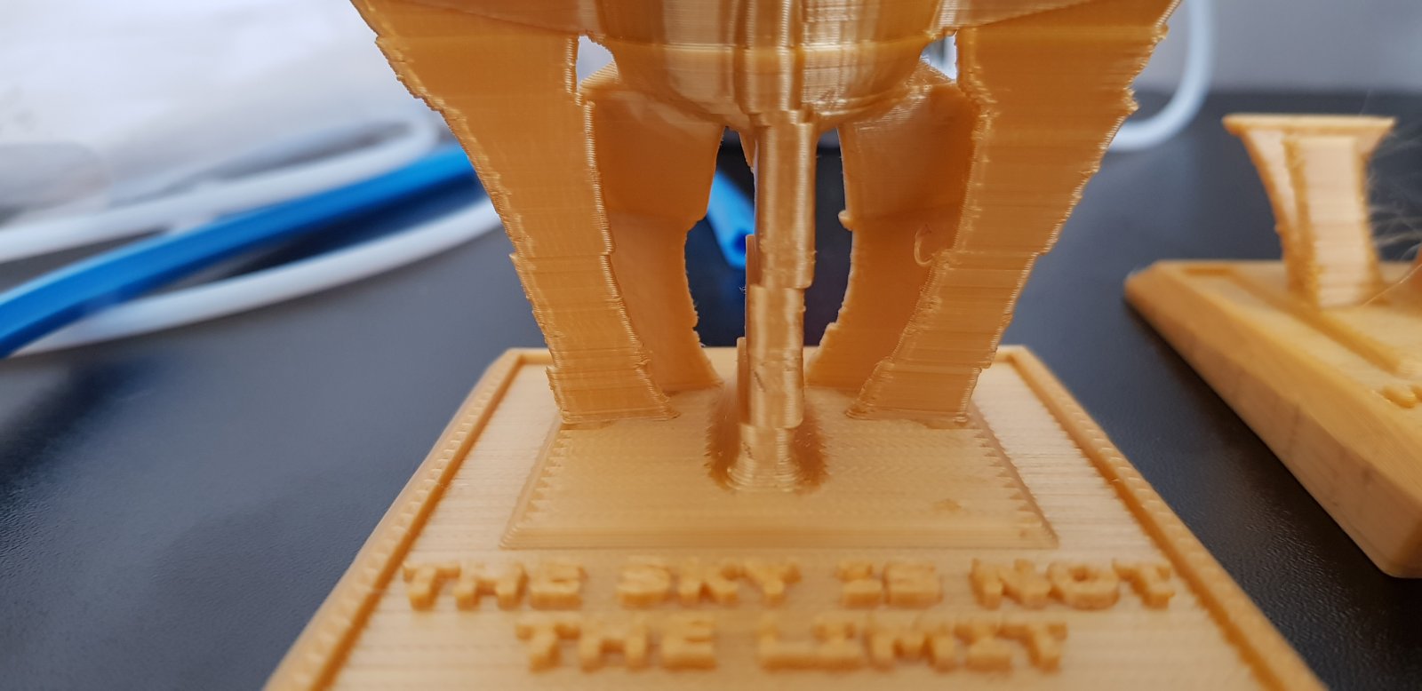

For who installed TMC2208 on A30, how did You set vref?
I installed them on my A30 v3.3 24v psu (GTM32 PRO VD - fw 1.38.59) for X and Y. I set them to 1.108 (X) and 0.986 (Y)
Y motor works hot but without problems for now.
X doesn't work hot but I think it loses steps. See the pic
Re: TMC2208 Firmware for A30, GTM32miniS/GTM32 PROVD
HI,gsxr2001
You can refer to it:
1.Try to increase the vref of the X axis drivers to 1.2V
2.Try to decrease the speed of travel to 100MM/S
