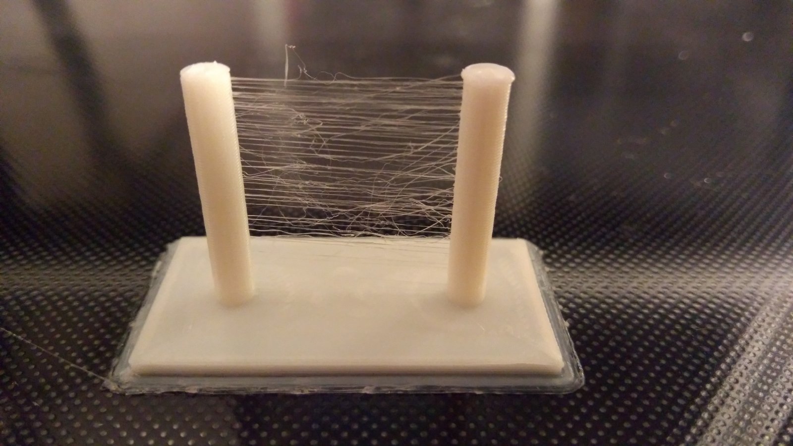

BR365
Posts: 57
Joined: Mon Apr 16, 2018 7:24 pm
Re: Profiles for Repetier Host / Slic3r for A20M?
Post by BR365 »
Hi Vert,
I guess, the only possible solution is to remove these disks.
E-Steps changed to 422 (Calibration done), ...
No new result depending the stringing.
