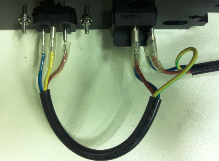

How do you connect the wire to PSU , is it like this:

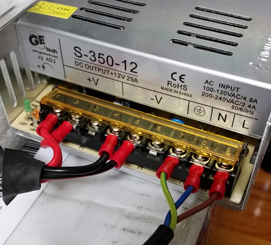

Yes. My psu looks a little different.
2015-04-11 02.23.09.jpg (515.43 KiB) Viewed 13063 times

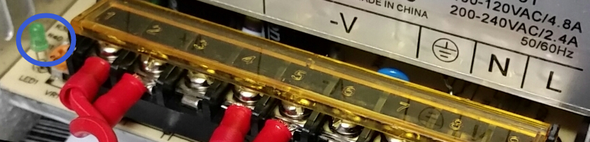

When you turn on the printer, is this light on? Is the fan in PSU working?

No, the LED circled in the image is not illuminated, nor is the fan working.

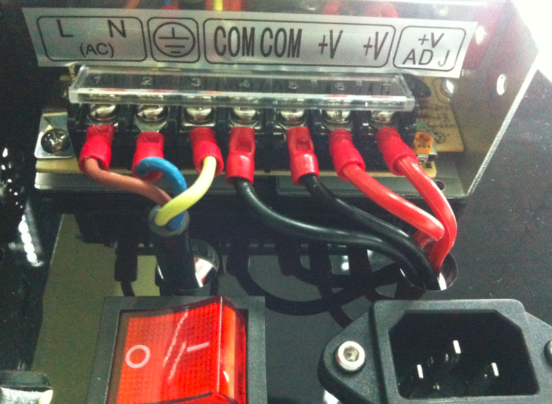

Can you take a picture of back side of the red switch?
