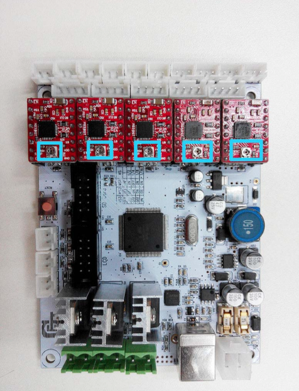

They are connected as the instructions say....
Screen Shot 2015-05-27 at 8.24.31 PM.png (431.79 KiB) Viewed 11248 times

So before I start this and try again this is the correct way to install the drivers???

x306xcptnkirk wrote:So before I start this and try again this is the correct way to install the drivers???
Yes, this is the correct direction. Because the driver you are using is DRV8825, and the driver you see on the internet is A4988.
