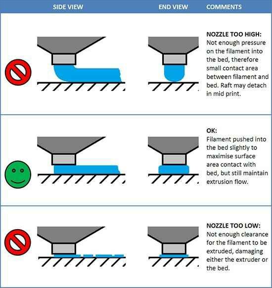

It seems that the filament can put out smoothly, then it just cools down in the air.
The nozzle is too high and far away from hotbed so that filament cannot stick on it.
You can level the bed first according to user manual.

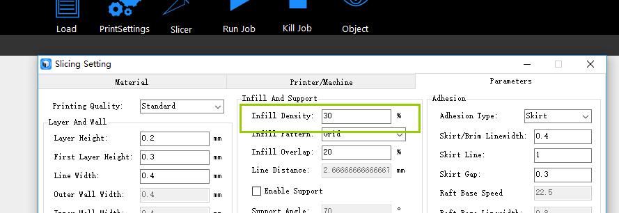

HI! I saw your video.
The filament sent with the printer is PLA,
hotend temp: 190-210C
hotbed temp: 60-75C
I think you can increase the infill density.
I also notice that there is some layer shift with the cube.
You can check if is the voltage of A4988(X-axis) a little low.
And check the belt, maybe it's not tight enough.
hotbed temp: 60-75C
