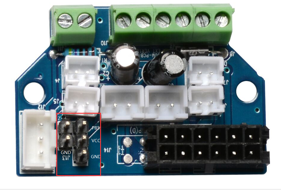

or >
green - red - yellow
black - white

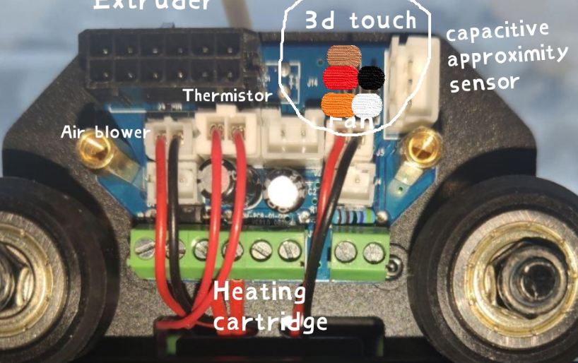

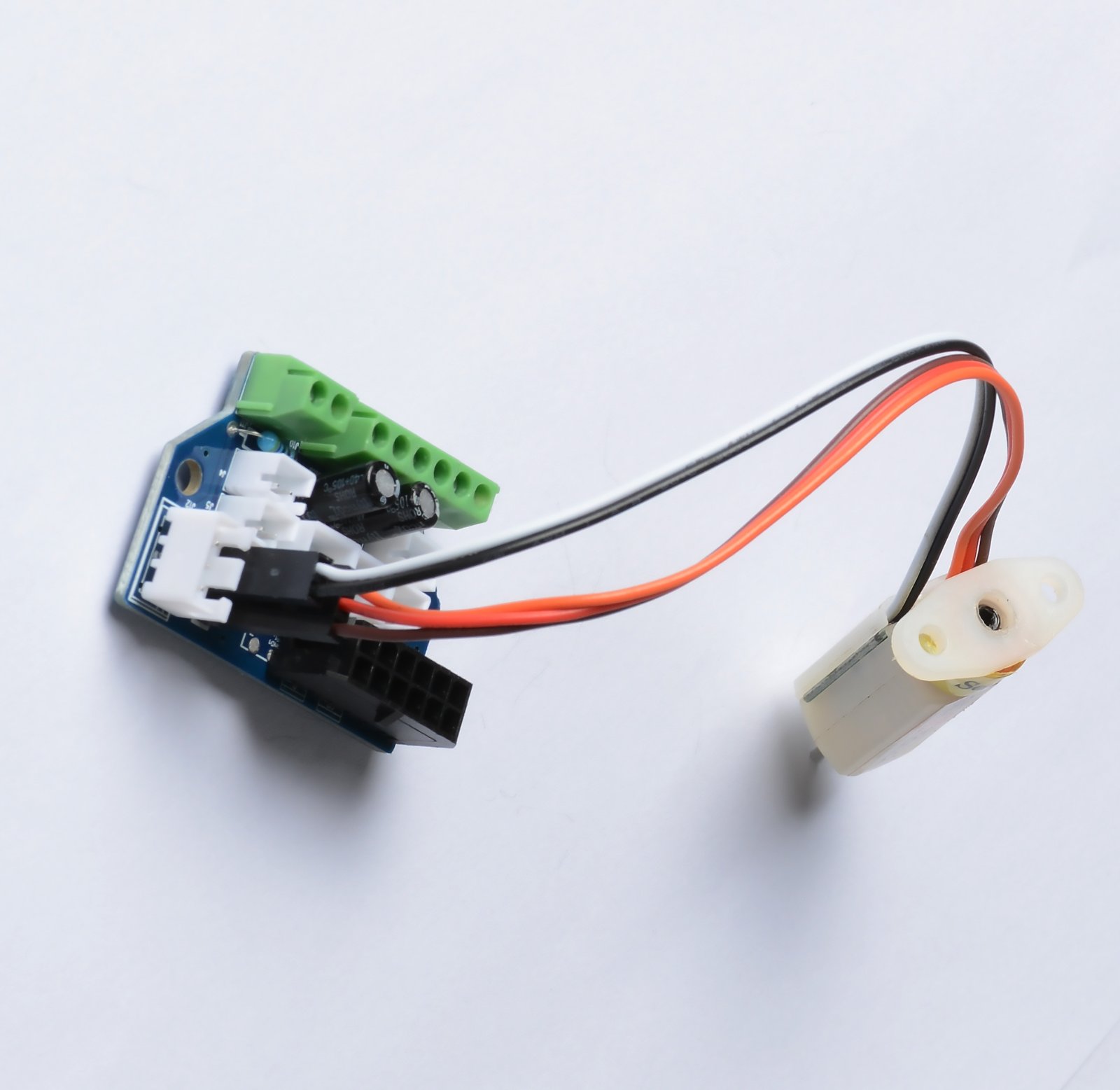

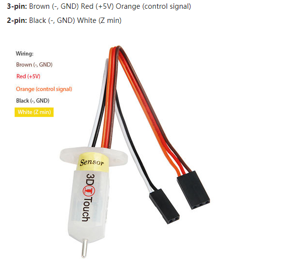

Could you also make a photo with wire colours for the extension board of the A30? I want to connect the 3d touch.
Greetings
Re: extruder Extension Board diagram
Hi, you can refer to this:

But how? My extension board looks like the first photos in this thread.

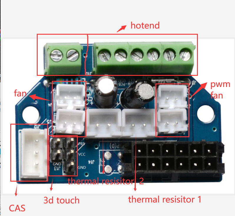

Is it possible that the first photo ist wrong? I thought the capacitive sensor uses only 3 pins (the lower ones) and rhe 3d touch the upper 5 pins? Or am I completely wrong?
Greetings
maybe this can help you.

Thank you!

William wrote: Wed Apr 15, 2020 11:06 am Hi,
Do you have the full pinout of this board? I am trying to convert my A10M from 2in1out to a 2in2out, so I need to add a hot end heater and a thermistor. Is this extension board compatible with this modification?

William, i'm interested in the full pinout of the new extension board too!
Thanks in advance)
Maybe it can help you :D
