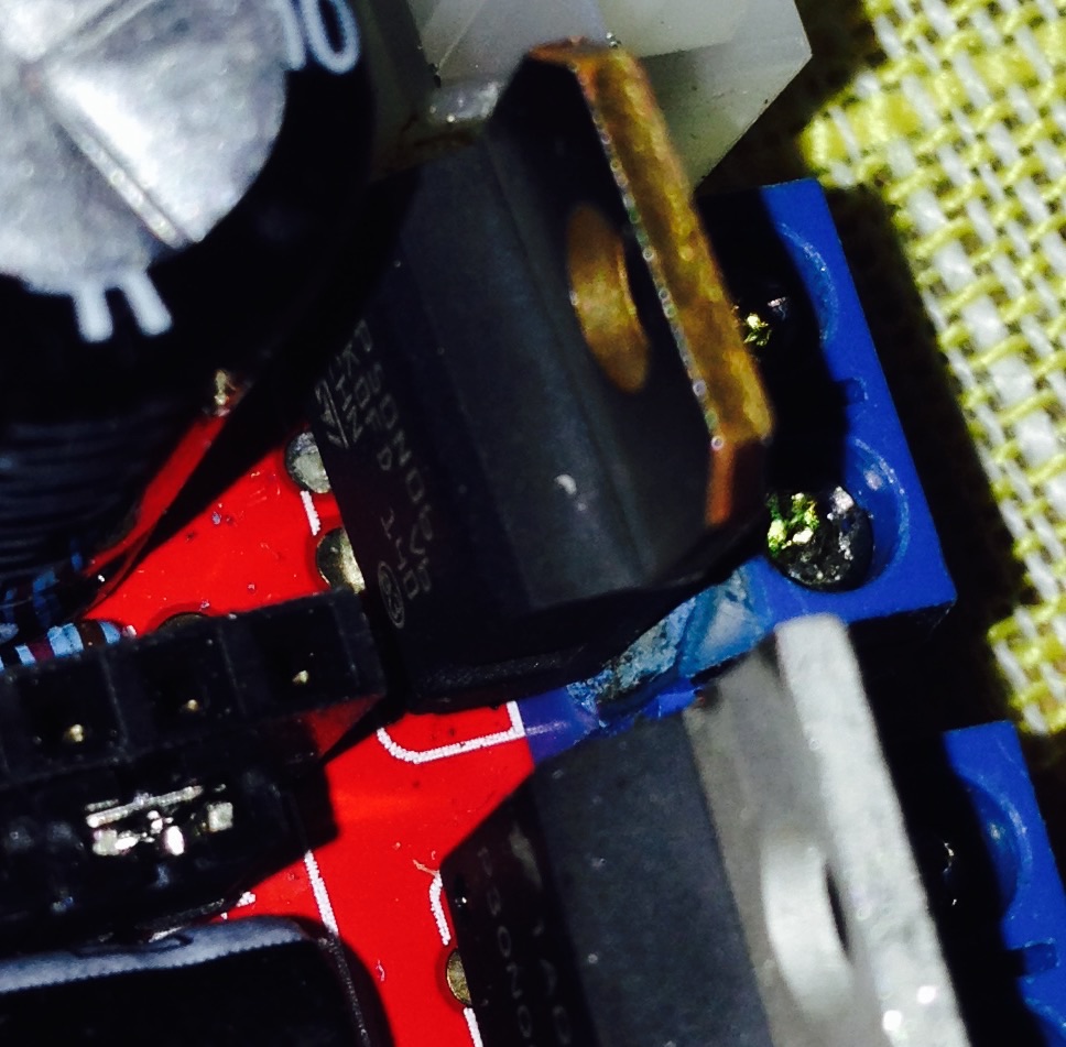

Pgioy
Posts: 18
Joined: Wed Jun 03, 2015 12:51 pm
Re: Mosfet problem
Post by Pgioy »
hello, I did change the mosfet again as seen in photos but the problem persists, he continues to overheat and burn all around.
