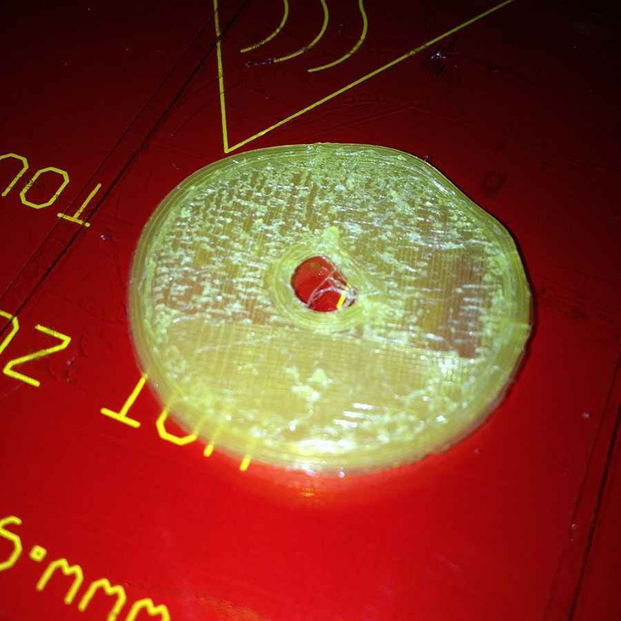

here is a picture of the latest print i tired, as you can see the print started but becomes stingy and lumpy and the extruder blocks causing the motor to pulse.

I am so sorry, I ignored something, If there is a big gear on the extruder, the Estep is 760, otherwise, the Estep is 95.
Please take a picture.

I have the mk8 I'll try turning the ester down from 100 to 95. If I manually extrude it works we and will extude smoothly.

Could you please take a picture?

I can what do you need a picture of the pic in the above post is of the printing results I have had on my last print. If you need a pic of something else I will post it when I get home.
