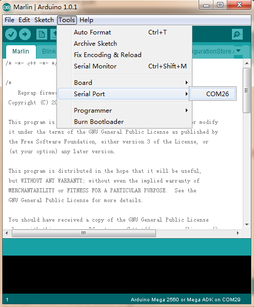

I just bought and put together a prusa i3 aluminum, and am having the reversed x and y stepper motor problem. I downloaded and changed the relevant firmware file, and using win7 and arduino version 1.0.1 as recommended absolutely cannot upload the firmware. It seems to be a usb connection problem; if this issue has been addressed prior, please refer me to the link. I read through a bunch of pages here until my eyes burned, and didn't see it. Thanks.

I guess the firmware can be compiled successfully,but can't be uploaded?Right?You can attach a picture about the error.
Did you select the right COM port or was the board detected successfully by your computer?You can open your device manager to have a look:

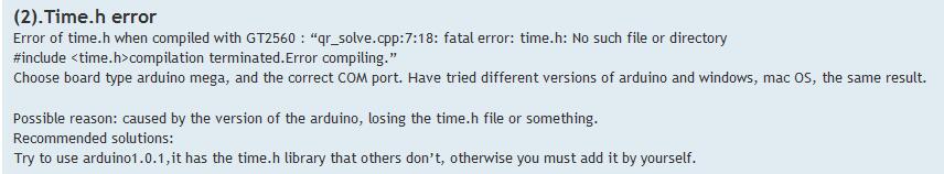

You are right, Arduino version 1.0.1 compiled it without a problem, and I did have the appropriate COM port selected (It was the only choice anyway). The program says it's uploading, then after a few minutes gives a timeout error. I don't remember the exact wording, but research indicated a connection issue. The board seems to get detected correctly. I have programmed arduinos before, so am familiar with the process. I did solve the reversed stepper problem by rewiring the steppers directly, but would still like to get the firmware issue solved.
Re: Firmware for geeetech 3D printers
I saw this before,but you're using 1.0.1 now...Maybe you can try other versions?
