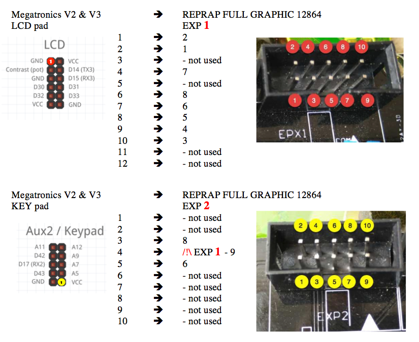

Re: Full Graphic Smart Controller, with Megatronics
I know megatronics V2.0 is obsolete ...
anyway I got one and a LCD, I spent time to make its working with Repetier last version,
now it works, please forget the smart connector and use your own wires like this : ]
