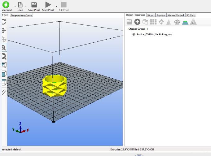

after uploding the file for printing and the press print, it took me to this window

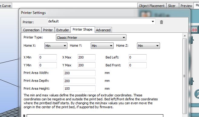

Then, when I go to the printer selection. i cant see the yype of my printer.so I chosed classic printer as in the below picture:

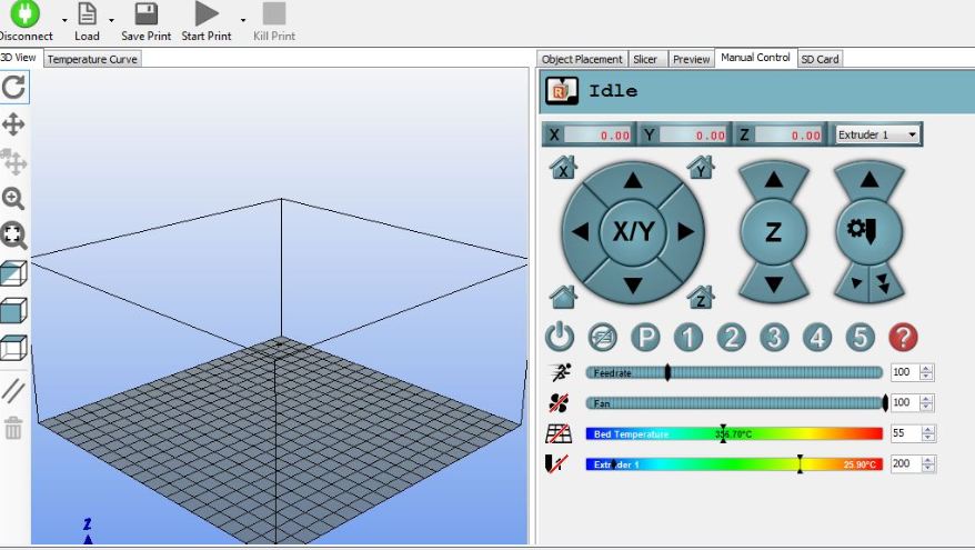

after that, wen I upload a file for printing and press print, no thing happen,instead it take me to another window.moreover i noticed that the extruder temperture not changing and heating at all. so, please advice what to do.

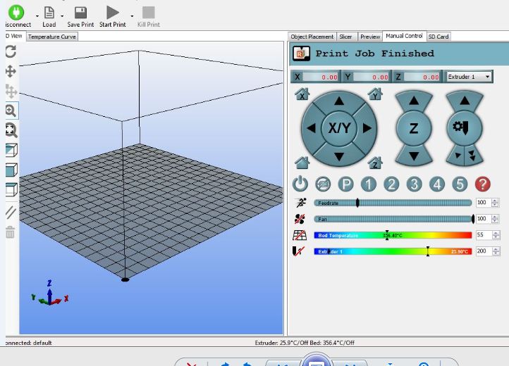

after pressing print, it take me to this window directly,So please your recommecndation is required to rectify this problem.

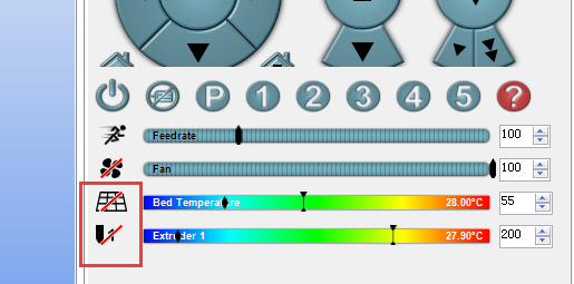

If you want to heat up the extruder and hot bed, you should click the 2 icons highlighted in the picture:

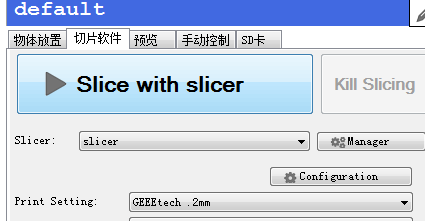

If you want to print with the stl file, you should let the software slice first, click "Slice with slicer" as shown in the picture:
