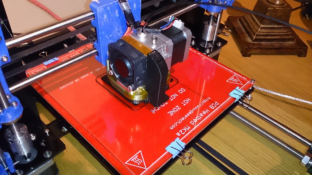

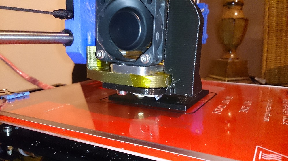

Post by jgvonk »
Here the pictures of the installed Fan duct. Fan duct falls below the extruder suspension for the Geeetech Prusa i3 Pro B and the original screws can be used.

Post by Justinb81 »
Is the extruder holder different as well? I see your extruder is more to the right.

Post by jgvonk »
It is the holder of the extruder Geeetech Prusa pro b. Is in the zip file

Post by Justinb81 »
Yes, I get it now. My metal plate between holder and extruder was flipped the other way placing my fan more to the left of the bracket. I've changed it now and tried the fan duct. I have a feeling it blowing to much on my heater block now. It takes for ever to reach its temperature. I'll try and rotate the block.

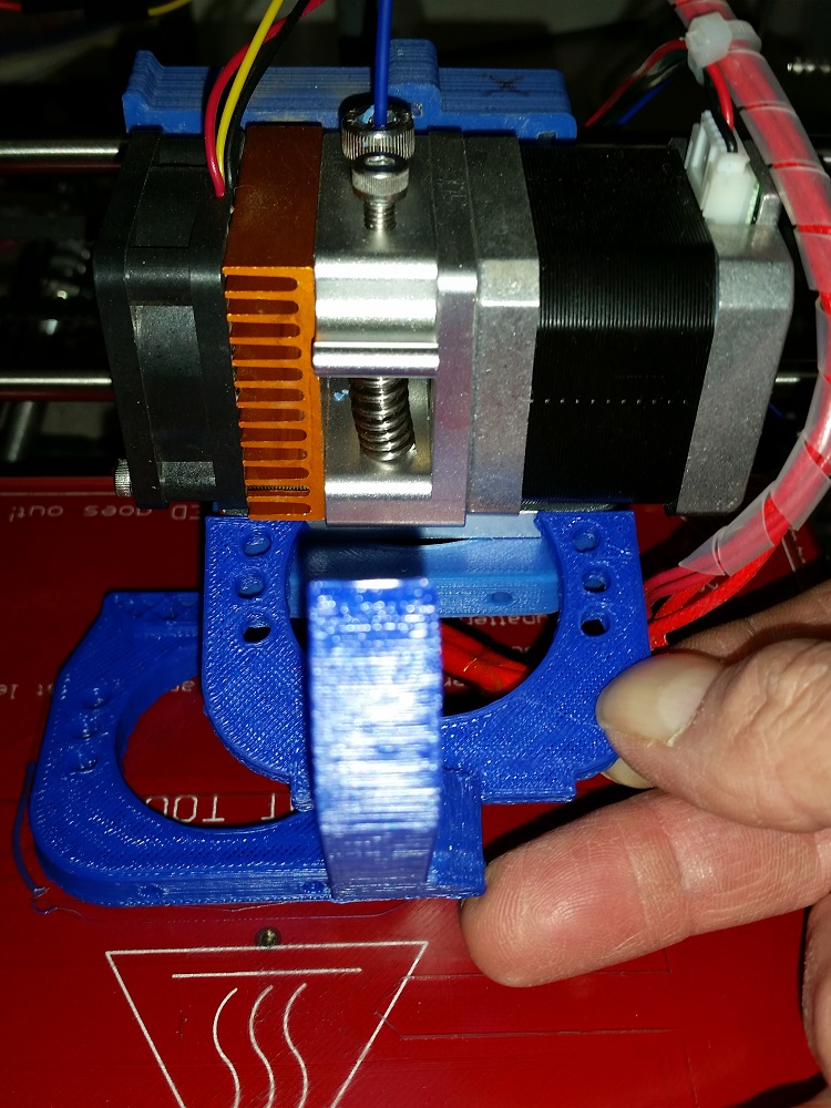

Post by szeiger »
I have the same issue with the position of the duct, are we missing something? I'm printing the other stl you provided but it looks the same as what I already have. Please advise, and know the we appreciate your efforts.

Re: Fanduct for Prusa i3 Pro and Pro B for better resolution
Post by szeiger »
This pictures goes with my last post.

Post by szeiger »
I'll rotate the plate as mentioned above and give it a go.
