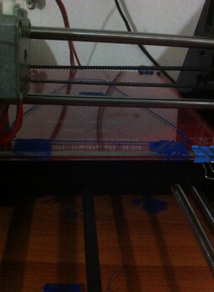

hi,
after applying the settings that you gave me it does not print well. it prints rectangle instead of square and prints out of the bed and it does not fill properly
i have attached the picture pls check and it printed well with default settings much better than this. what myt be causing this ?
worst print :(
worst print :(

Is the model you are printing too big to print? If not, do you have firmware? I can tell you how to modify relevant parameters.
