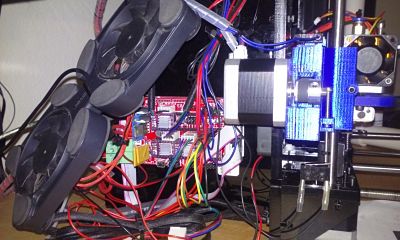

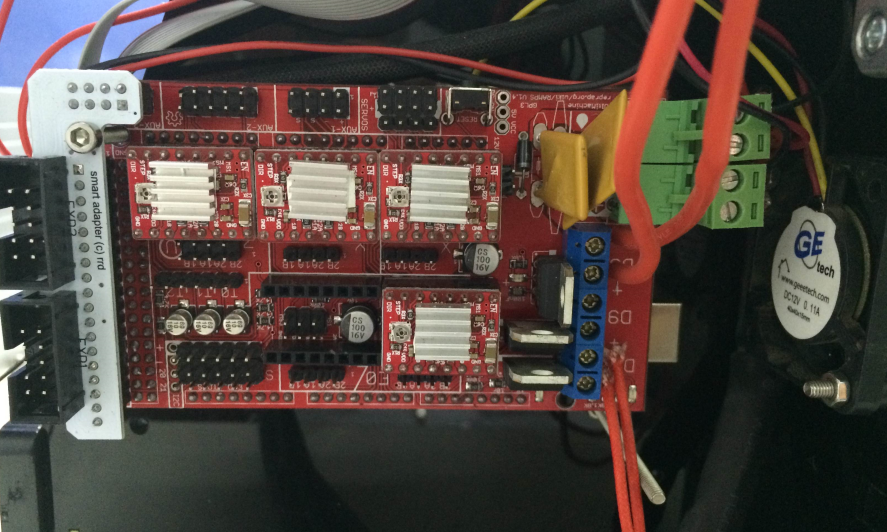

Please mount the board on acrylic plate like this, to make sure the fan can cool the MOSFET down. It is very important!

I have 2 65mm fans cooling the board running off my computer, over heating isn't an issue but thanks for the warning.
