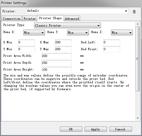

Re: offset nozzle bed creator mini
Did you set the correct settings?
- settings.jpg (122.91 KiB) Viewed 12328 times
- slic settings.jpg (288.79 KiB) Viewed 12328 times
hi Mark , I set as on your screenshot .
the nozzle no longer out of bed but is still not centered resulting object is cut it is not printed entirely ...
the creator mini, when the nozzle is at home she is out of bed ...
repetier in the small circle indicates the nozzle ?
Thank you
Thank you

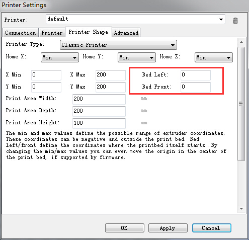

Try to adjust the settings in here :
- QQ截图20150815111538.jpg (129.01 KiB) Viewed 12290 times
thank you , I'll try and come back to tell the result .
