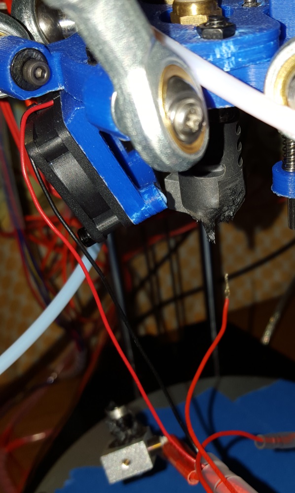

On my G2S, I can't get extruder 1 to go above 190 degrees. Extruder 2 does.
Ideas?
Right as I was about to hit send, I noticed that my hot end was at an angle. I suspect my thermostat stopped working, but the heating didn't and it melted right out.
This was my first print attempt (once I got the extruder working). Can I get a replacement?

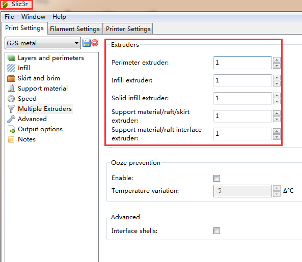

In the mean time, how hard is it to print on extruder 2 by default, so I don't have to take everything apart?

- melted
- 20151107_155914.jpg (163.97 KiB) Viewed 15537 times

You can contact the seller to replace the hotend. And what's the output of your PSU, is it 20A? seems it lacks power to get the temperature to above 190 degrees.
" how hard is it to print on extruder 2 by default"
you can choose the extruder you want to use in the slic3r.

Thank you. I will check the output, but extruder 2 easily got to 205, and given the melting, I think extruder 1 went well above
