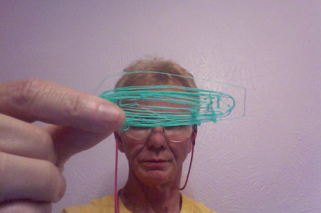

Photo on 11-13-15 at 7.40 PM.jpg (58.24 KiB) Viewed 7639 times
Whenever I try to print after a couple of layers the extruder no longer lines up with the beginning of the print

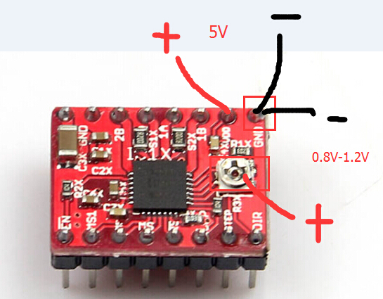

No, not the 5V one, you need to adjust the voltage through the potentiometer here, and increase it to about 0.9V.
A4988 voltage.jpg (217.64 KiB) Viewed 7601 times
