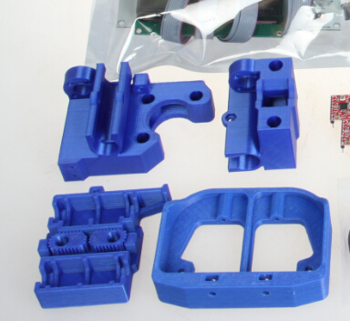

hello,
can you send me the whole stl files like the picture. i need this for repair my damaged geeetech prusa i3 pro c.
thx

Re: Printer parts STL file - Prusa i3 pro C
Here it is:
download/file.php?id=1669
