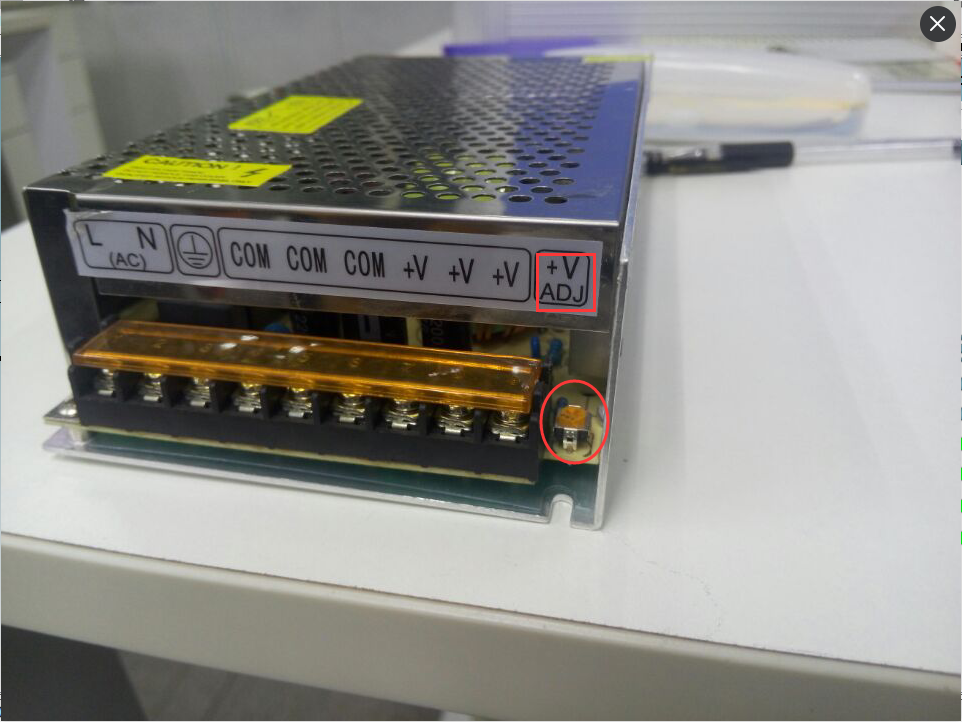

Torm, can you please explame me how rise you heatbed voltage to 13,6V??
I get only 10,7V on my headbet...
Re: I3X Acrylic 8mm /GT2560 hotbed wrong temperature measure
You can test the DC output(around 12V) of the PSU,you can adjust the potentiometer if the output is not sufficient:
