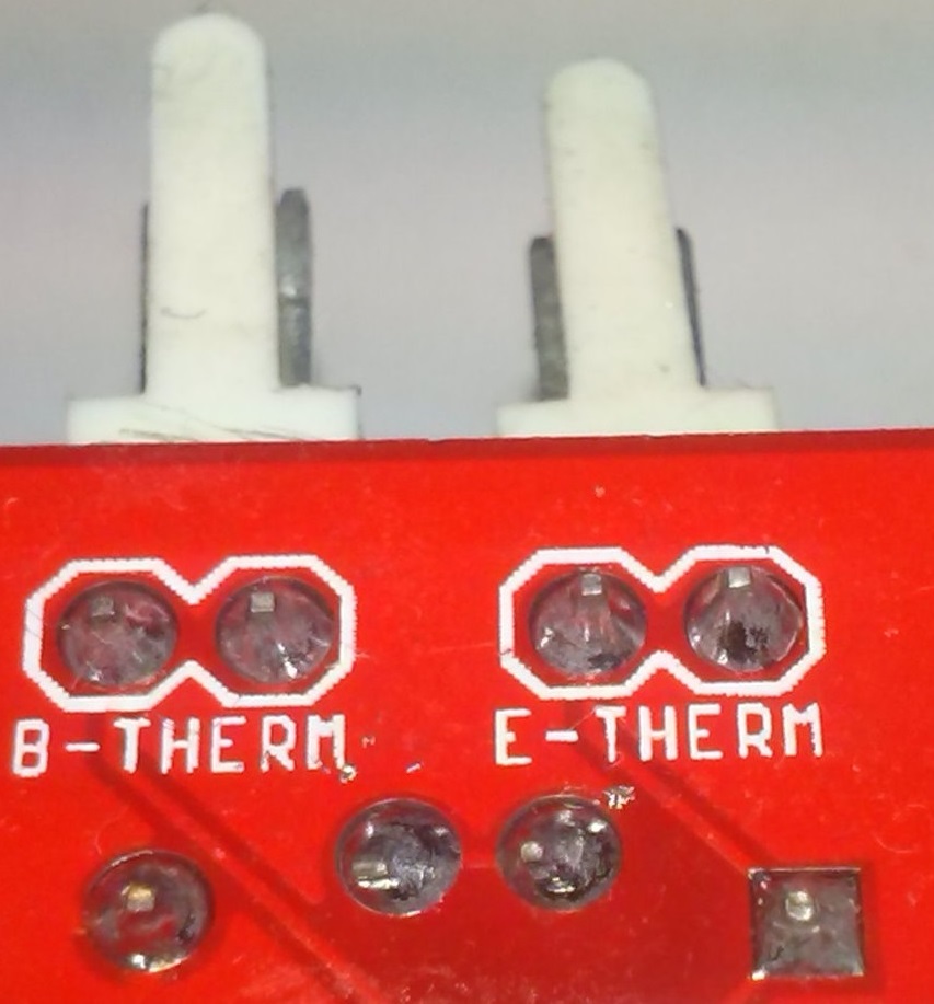

how about the back of the connector? does the pins have a short with each or not? If not then seems you'll gonna need a new board ..
Re: Need help
Hi Mark
As you can seen in the attachment, there is no short circuit. Even if it was a short circuit, lcd screen should display 358 C and not 266 C Error. Finally i need a new board ?
