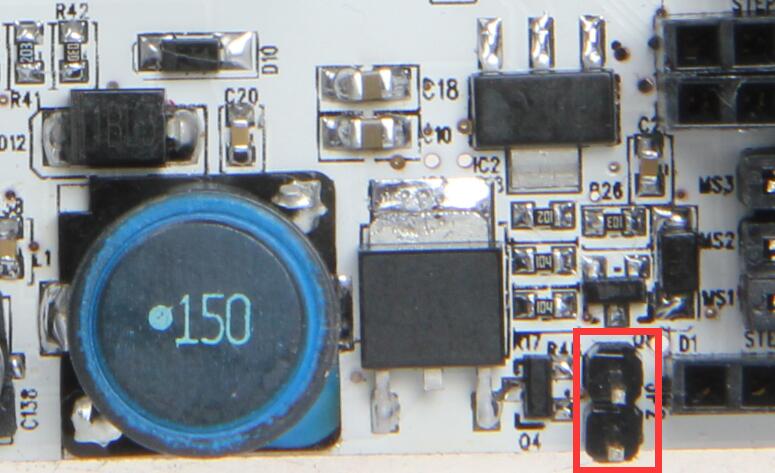

Try to use a jumper cap to connect the "JP2" connector,and tell me how it goes.Look the "JP2" in the following picture:

Re: G2/G2S
Post by Wolff »
Thanks!!. Unfortunately there is no change. I am very troubled by the fact that not even a fan is running. I am working on a video. Thanks again
